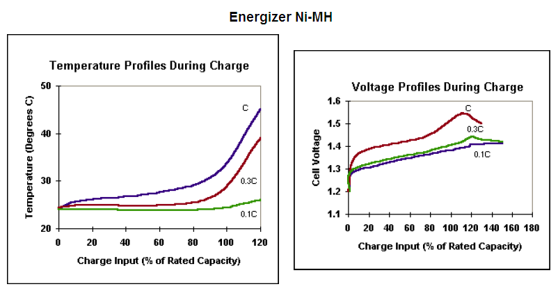

High pressure and temperature build up quickly just before a Ni-MH cell reaches full charge. At higher charge currents detection of full charge is important to prevent damage and even an explosion.
Fast chargers for Ni-MH rechargable batteries detect the tiny drop in charge voltage that occurs near full charge then stop the charging. Backup temperature and pressure sensors ensure cutoff if the charging circuit misses detecting the tiny voltage drop.
Energizer recommends charging at 1/10th the battery's rated capacity if sensors aren't used, with an additional 20% extra time to make-up for losses. They say a battery's life is reduced if overcharging continues.
Ni-MH cells are charged with current, not voltage. The voltage must be high enough for the current to occur.
On graphs, rated capacity is at a current called "C". Here are a couple of graphs from Energizer:

So the ideal charging voltage is 1.5v? and if so how long would it take to charge.
No. Any voltage could be used for charging, as long as its voltage is high enough for your current-limiting circuit. One million volts could be used through a 12M resistor. When the battery is fully charged, each cell will be about 1.45V. Frequently, a constant-current circuit is used to limit the cuurent so a low voltage or a high voltage battery can be charged.
As explained before, the charging time is dependant on the amount of charge current. Divide the value of its rated capacity (850mA/hrs?) by the charging current (85mA?) and add 20%. This example will be fully charged in 12 hours. If the charging current is 170mA then it will be fully charged in 6 hours but will be damaged if its charging isn't stopped.
