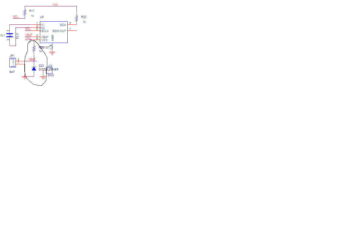

DS1307 is a real time clock. I use it in my project. The battery for backing up during power failure is specified as 2 to 3.5 V. I used CR2025 3V lithium battery which is working fine.
Can I use 3.6V 60mAH Ni Cd battery instead as in the circuit with a zener ? What is the resistance value recommended?

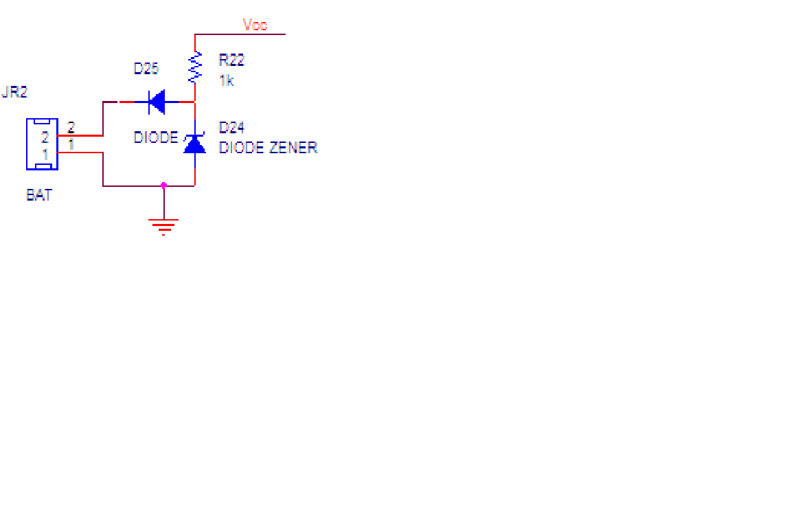

You could just connect a low voltage diode in series with the battery positive terminal.
A BAT85 or schottky low voltage diode should be OK.
Also I would connect a 100nF cap from the DS1307 battery pin to 0V.

Like this?(ref attachment). Why do you suggest a 100nF capacitor ?

Here, earlier I used a 3V (non rechargeable) battery. Now i am thinking of using a rechargeable battery marked as 3.6V. I want the charging from 5V supply of the IC. But the IC data sheet says the recommended battery voltage as 2 to 3.5V.
So I want to
1. Limit the voltage.
2.Charge it from 5V
Earlier I connected the 3V battery directly to the IC pin with out any extra cap or R .

You are confusing two different points.
1..If you use a 3.6Vbty you need to drop the voltage by using the simple diode dropper in my post. This will meet the Vbty 2V to 3.5V requirement stated in the DS1307 data.
2.. The battery 3.6V NiCd charger is a different/additional circuit.
There is a communication gap. In my OP i asked for resistance value to charge the bat from 5V (pls refer fig) , not for dropping the voltage.
Both the above (charging also) are my requirements.

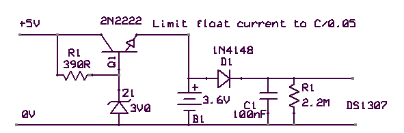

Have a look at this circuit, keep the charge current to C/0.05 for simple float charge.
BTW: Looking at your OP, there is no reference to Charging or a 5V supply.
What is C?
I showed a resistance connected to Vcc(5V). Then my doubt was about the value of R(indicated charging current)
C for the battery you have [60mAH] is 60mA.
So C/0.05 = 0.06/0.05 = 1.2mA.

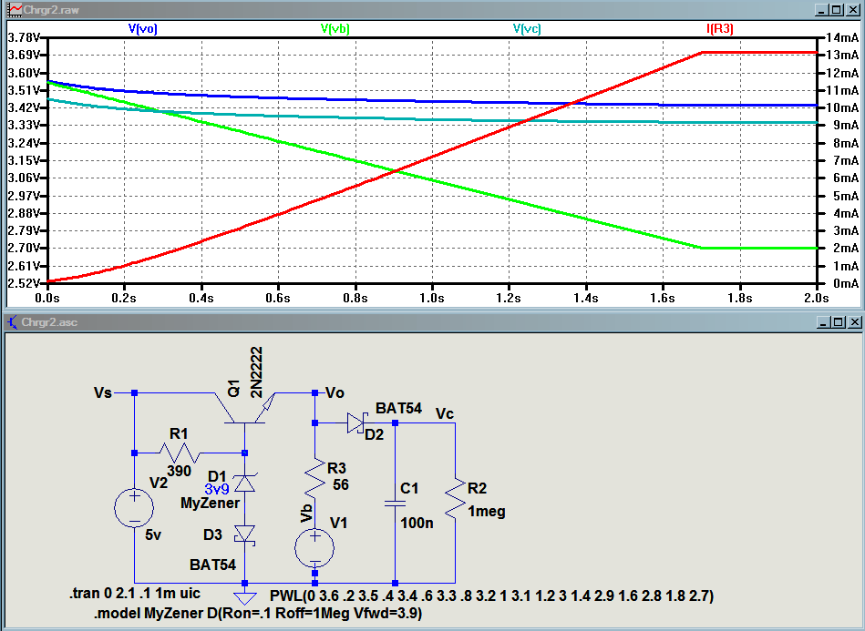

hi Hans and Gayan,
A slightly modified circuit.
