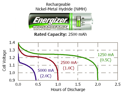

A Ni-MH cell is 1.4V to 1.5V when fully charged and is still charging.
The voltage quickly drops to about 1.25V depending on how much current. Then its voltage slowly drops to 1.1V then drops quicker.
A voltmeter will not tell you how much charge remains. You need brains to calculate it.

The problem with designing a NiMH fuel gauge is that those batteries hold a rather steady voltage from 90% full to 20% full. You might do something that calls 1.26V or higher "90%-100%", then 1.25 to 1.22 = 89% to 20% full. The last 20% is when the cell drops from 1.25 to 1.0 volts. Or, you could call anything over 1.24 volts "safe" and start an alarm at 1.2 volts. These are rather crude methods, but they might be sufficient for you.

The discharge voltage is not linear.
