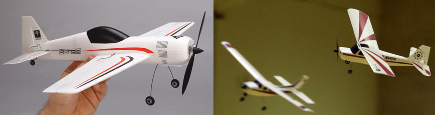

These ones are small and fly is a school gym or outside when there is no wind. They weigh 20 grams and 34 grams complete with battery, receiver and servos.
