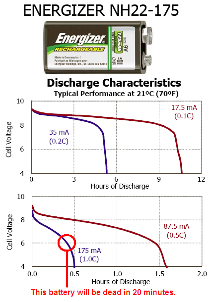

The No-Name-Brand 9V Ni-MH batteries are spec'd at 200mAh and at 250mAh.
But Name-Brand Energizer ones are spec'd at 175mAh and at only 35mA and when their voltage has dropped to (the datasheet says 1V but I think it should say 5.6V).
At 160mA it will last only 20 minutes.
Energizer 9V alkaline batteries are rated at 625mAh but only when the current is only 25mA and when their voltage has dropped to only 4.8V.
With a load of 160mA they will last 2.5 hours when the voltage has dropped to 6V for each one.

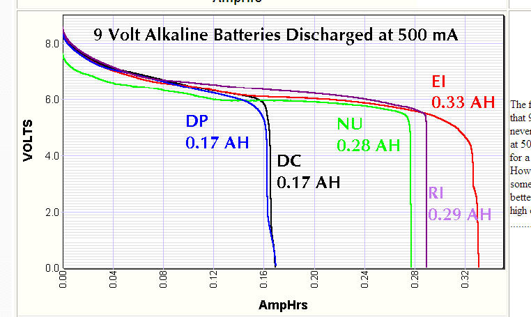

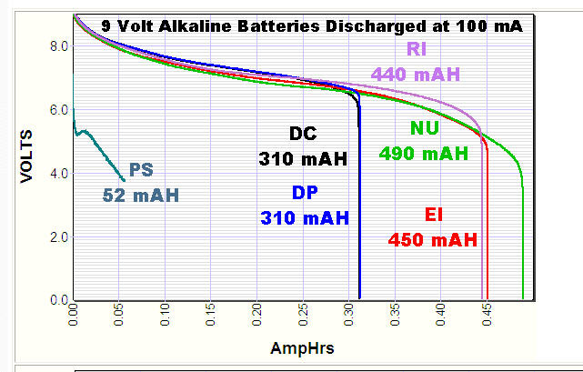

here is some test data on 9V alkalines discharged at 100mA and 500mA:
https://www.powerstream.com/9V-Alkaline-tests.htm

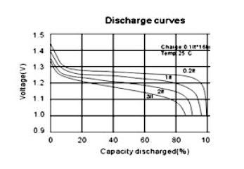

That surprises me that a NI-MH would lose so much A-HR capacity discharged at around the C rate. This curve from another NI-MH 9V shows more what I would have guessed: at 1C you get 80% of the full rated capacity (200mA-hr). That would mean you could get at least a full hour at 160 mA discharge rate.

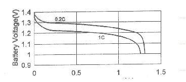

Here's a generic discharge curve for NIMH that's easier to read:
The energizer ni-MH 9v battery is pretty good at low currents but is lousy at higher currents.
You show single cells that do not have the many resistive connections in a 9V battery.
