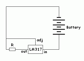

i am currently doing a project on a battery tester. To test the capacity of a battery, i will need to discharge it. One of the requirements of my project is that i need to discharge the battery at a constant current. Normally, to discharge a batt, we just have to connect the batt to a discharge load (ie. a resistor) but in order to discharge at a constant current, i would have to change the resistance of the discharge load. Although i could use a variable resistor to vary the resistance, but i have to discharge at a current of about 300 mA to 400mA and also i will have to vary the resistance electronically. I found that a power mosfet could handle current 300mA and higher. hence, i would like to ask that by using a power mosfet (eg. mtp3055) with a heat sink , could i vary the resistance of the mosfet's channel? Thanks in advance !!! help needed

Why not use a LM317 regulator for the constant current discharge?
I think it is perfect for this job.

Sorry, here is the picture :oops:
Ante :roll:

The LM317 uphold 1.2 V trop over R so if you want 300mA (1.2 / 0.3 = 4) R is 4 ohms and the power rating is (1.2 * 0.3 = 0.36) use 0.5W or more to be on the safe side. With lower heat in the resistor you get a more stable current.

You have to use Ohm’s law. The LM317 maintains 1.2 Volts drop over the resistor and its R=U/I. And avoid draining the batterys to a lower voltage than 1.0V/cell unless the manufacturer states this for capacity measuring. This circuit is not suitable for less than 4 cell-packs.
