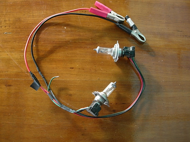

This is my battery load for testing capacity 55W to 230W. Basicly free from the scrap yard 55/60W head light globes & bases, use as many as you require.

I use bulbs as dummy loads too, the drawback though is the resistance is much lower when cold, esp with halogen.
If I were to use MR16 12V 50W Halogens, the inrush current looks scary. The ratio of cold resistance to hot resistance seems to be ~0.08, meaning that since I plan to switch them with an N-FET, it will have to accommodate an inrush current of hundreds of amps...
