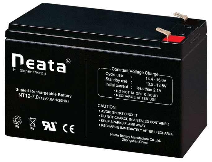

This is how my battery looks like ,but dead one(yet providing 9v abd 0.5A).Now say can i use that for my above need

If it wont take a charge then it's gone I'm afraid.... If you put a load on it the voltage will drop further..
I have many of these things and I recharge them with a bog standard car charger ( on slow charge )....
Put it by your door. It should keep the door open. I think 9 volts is about right for a door stop.
Your battery tells you it's rating ... 12V 7 A/hr.
You need to charge it at the initial charge rate to see if you can bring it back to specifications. Search for battery university and read about the care and maintenance of your battery.
