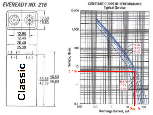

If Energizer still made their cheap "Classic" (the red one) carbon-zinc 9V battery, a new one would supply 25mA for only 5 hrs at 25mA. They haven't made them for years but I still see them in stores. What is the shelf life of a carbon-zinc? 1 year?
An Energizer alkaline 9V battery supplies 25mA for about 25 hrs and its shelf life exceeds 5 years.
An Energizer lithium 9V battery (I haven't seen them in Canada, but their AA cells are great) supplies 25Ma for about 70 hrs and its shelf life exceeds 20 years.
Go to www.energizer.com yourself and look at their battery spec's. :lol:
