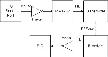

ok i think i beginning to get what u mean. So is it something like the picture below?
So the problem is caused because the signal will have a sequence of highs until the next byte of message is sent. These highs will cause problems in the transmission (synchronization??). So we need to invert the signals at transmission and then invert back at the receiver side to eliminate these continuous highs.
Am i correct on this??

Yes, but i would place the TX inverter between the MAX232 and the transmitter.
Yes, the transmitters (or it might be the receivers?) are designed for only AC signals, so you can't send a HIGH longer than a few milliseconds. If you have a double beam scope, stick one beam on the transmitter input, and the other on the receiver output - you will see that continuous high levels break up and fall back to zero.
I followed Nigel's suggestion of adding the inverters at the input and output and it works!! Thanks Nigel :D
