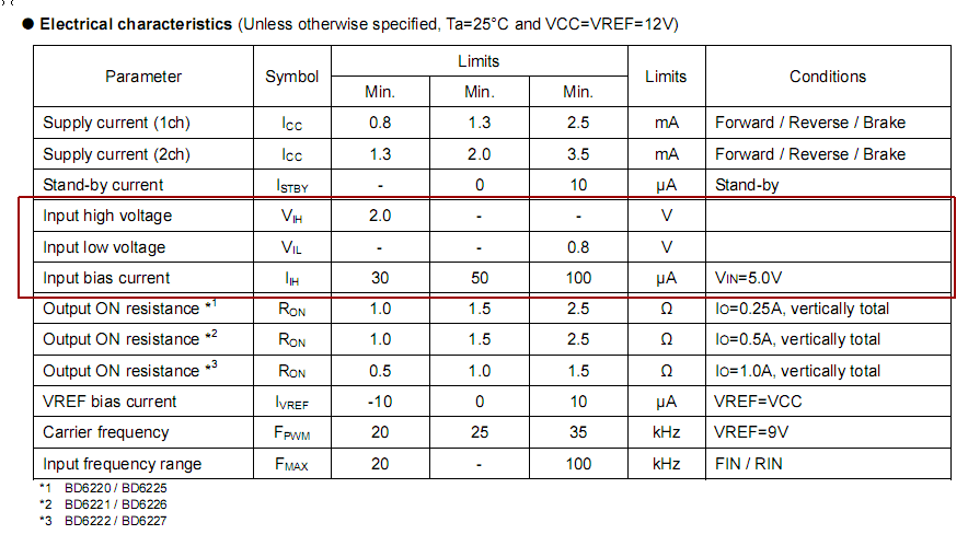

I am looking at using the ROHM BD6222 Half bridge driver IC. I have looked at the specification sheet and cannot see if the control inputs are TTL signal compatible.
Could someone look at the sheet and tell me if they can be directly connected to a micro controller
https://www.turbofast.com.au/bin/bd622x_series-e.pdf
Ray.
You state TTL and then a micro controller, which is CMOS technology.
Looking at the datasheet I would say its TTL/MCU compatible.
