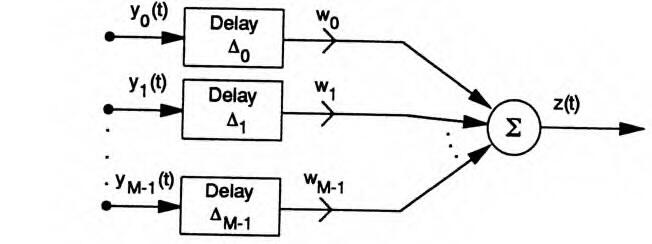

Hi friends.
Today when I was reading a paper on the net I saw a small word obout sonar and radar beamforming, then I did a search via google. I noticed that this job is down with "delay" and phase shifting of acoustic beams,
even I saw a thread here;that a guy suggested to another to use this way and use 10 ultrasonic transducers to avoid direct rotating his trasducers.
Well after reading some words in the field; I am not sure how making delay or phase shifting can curve abeam( like what a lens does for one or more light beams)!!!
My idea is that a device that makes a delay or phase shifting does not do a such job, but it delays the time of output beam, if my guess is right, then how it acts like a lens?!
Thanks for any input

no it creates a time dependent interference pattern which changes the direction of the wave/beam.

It uses constructive and destructive interference. You have a lot of work ahead of you, mostly in how you must have complete control of the transducers involved. (I think I was the one that put forth the idea).

I'm not "quite" sure how beamforming works exactly, but I imagine it's like this:
You have 3 sensors each with a 60 degree beam width facing semi-circular outwards. The sensors are 40 degrees apart (20 degree overlap in the beams.). You send out an sinusoid with an equal amplitudes and frequencies at the same time from all 3 sensors. The difference is the left/right sensor has 180 degrees phase shift (not quite the same as time delay since this is a finite-time signal- the left/right signals are inverted versions of the center signal). The left and right beams overlap 20 degrees on either side of the center 60 degree beam. They superimpose (add up) on 20 degrees of both sides of the center beam. Since they are 180 phase shifted (or inverted), they add up to zero. It ends up that the center beam now appears as only 60-20-20=20 degrees wide. Beam forming is used to artificially narrow down the wide sonar beam (beam width is dependent on frequency and frequency affects resolution and effective range so it's a constraint you can't mess around with too much).

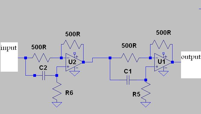

What is your idea about this delay circuit? the delay amount is determined by R5 and R6.
They are two "allpass" filter circuits.
so?!
I have got the circuit from a paper about beamforming.

If you have several overlapping beams and you delay or phase shifting the beams properly, you can get destructive interference (180 degree phase shift with respect) in the overlapping areas which artificially makes the beam narrower (only the non-overlapping beam remains and it's sides have been shaved off due to the destructive interference from overlapping with the phase shifted beams on the sides). It is only a time delay for infinite-time signals. In practice, where there are only finite time signals, it's a phase shift rather than a time delay. (For sinusoids they are the same for infinite time signals).
I'm not sure how much beamforming is used with radar. It seems to me it is more often used for sonar. Beamforming does not curve, bend or focus the beam the way you are thinking. What it does is use destructive interference cancel out the sides of the beam leaving a narrower center beam. It "shaves" off the sides of the beam with destructive interference.
A radar that beamforms and can see things behind it probably as a circular arrangment of sensors, so there really is no front or back.
