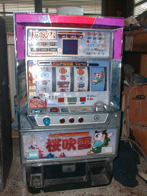

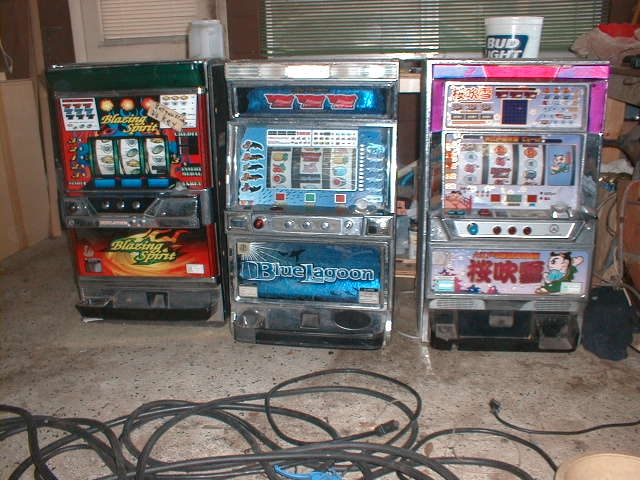

On top of everything else I've got in the works, my youngest brother just gave me some new toys to play with, three Slot Machines. Yes, the full size, real deal. I don't have the key, so first challenge is to break in. One looks like its been pried on a little on the side (brother I guess). Will probably go with that one first.
Anyway, two out of three have no power cord. The corded one was dead when I plugged it in. Really need to get inside and see if there are at least some cool parts to salvage. I'd like to get past the locks, with minimal damage. They all look to be of similar design, so chance of getting one to function might not be so bad.
Attached are some photos, and will add more to this thread as I progress. Aren't you a little curious about what's in the box?

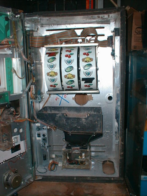

I got one open (the tampered with one). No money, just a single token. Least I have something to play with.
Attached a power cord and pluged it in, awesome fireball and blown fuse. Before the big flash from the fuse (maybe whatever was shorting), heard music and saw colored lights, wheels spun briefly. This all happened in a second or less, what a thrill...
Inside, there is writing in english, and some stuff labeled in chinese/japanese. The blown fuse is marked 250V 10 amps, need to hunt through some junk for a replacement. Have some 10 amp automotive fuses handy, but not sure they will work. Need to find the fault first anyway, work on it tomorrow.
There is a key switch inside labeled ON/Reset, hope that isn't part of the fault. Seems like everything starting up at power up would be a huge power draw, but then again would it blow a fuse everytime there is a power failure...
Hope they all have similar latch mechanisms, it was really easy to slip with a screwdriver. Haven't tried the other two, but should open with minimal effort.

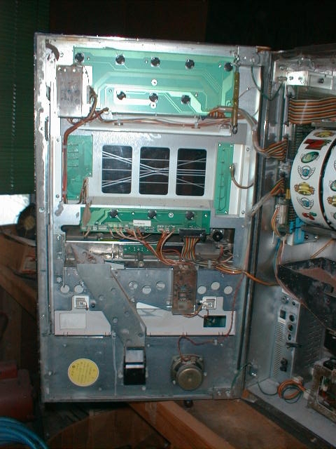

JACKPOT! I got a second machine open. Going through the side didn't work, was about to give up for the day, when decided to look at the bottom. There were some vent holes, one large enough for my hand to fit though. Just reach up, felt around and pulled on the latch.
Inside I found the power cord had been shoved through a hole in the back, two tokens, and most importantly the key was in the reset switch. Plugged in, flip the power switch... and it worked. Had to replace a few screws, but pretty much intact, one button cap missing.
There is a large motherboard on the top inside, lots of ICs. I'd think a PIC could run the whole thing (joke). Wonder if luck has much to do with these games. Will take some close-up photos and post them tomorrow.

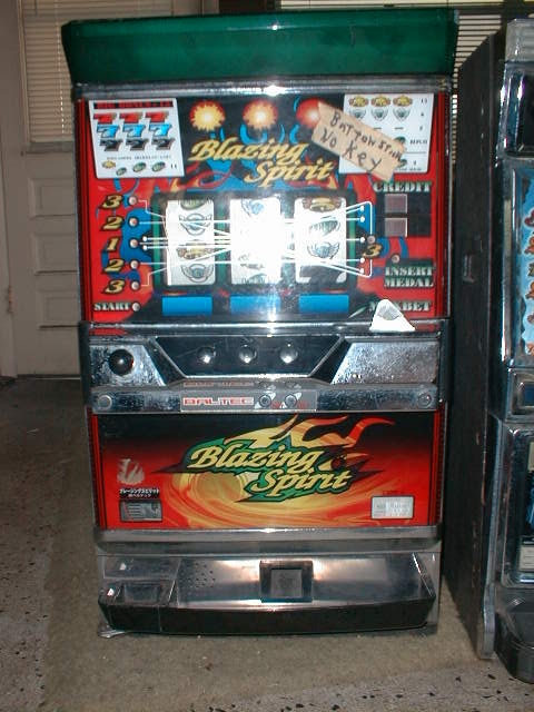

The third machine is going to be more of a challenge to open up. Tried through the side, couldn't find anything that moves. Holes on the bottom, but a little smaller. Couldn't feel around the latched edge much, coin hopper was in the way. Might hooks some LEDs up to a small video camera and take a peek that way.

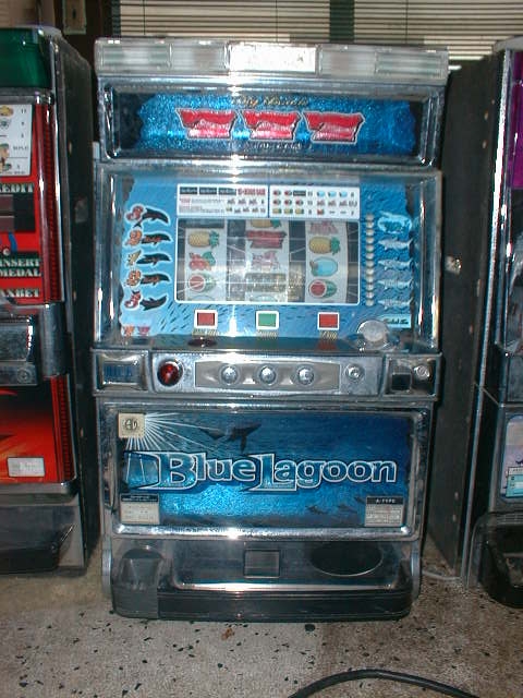

Just got the good slot machine to accept quarters. I wasn't too bad, there was a second set of holes under the opto assembly to mount them lower for the tokens slightly larger than a quarter. Had a problem with it rejecting quarters at first, but eventually figured out a way to get them past that part. I cut a piece of plastic (about as thick as card stock) to fit across the flip-up cover. Not sure if it'll take anything about the right size now (most likely), but no big deal.
There might be a problem with the coin hopper though. I only had a couple hundred quarters handy (state quarter collection...), but seems to empty out kind of quick. Will go to the bank monday and get about $200 worth, should fill it pretty good. Unfortunately, each machine has a different hopper and different connectors.
Just got the 'Blue Lagoon' machine paying out quarters accurately!!! Had to fabricate a small triangle piece of plastic to so that the quarters can just barely squeeze past the mechanism in the hopper.
This thing is almost 100% restored and converted to quarters. The button to select playing a single credit is broken and the cap missing. Haven't figured out the simple way to pop it out yet. The other way is taking apart the door. Wasn't a big issue, but now its the only thing left to fix. Pretty cool, since the only sites with this machine, sell them for $299 plus $60-80 shipping. Not bad for a freebie.
