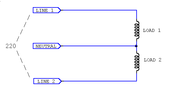

Before I get electrocuted I thought I'd better get some help. How can I use two triacs to control BOTH sides of a 220-volt line simultaneously? (60Hz-USA) I can't use just one because the load is referenced to neutral/ground on both sides. Any thoughts?
You need two triac (for each phase)

Thanks, Sebi.
Question: Should a diac be used in the path of the phototransistor? Most data sheets I've seen require one. What does it actually do?
DIAC is a trigger device, useable in dimmer circuits. For on-off switching no need. Or You need a dual-dimmer?

Hi Agent 009,
Triacs and diacs belong to a special group of semiconductors known as "thyristors". This link might answer your question better than I can:
