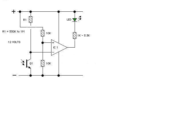

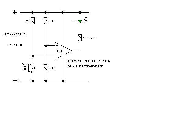

Apologies for an absolutely basic question. See two circuits attached. Are these circuits equivalent? My beginner's reading of Kirchoff's Current Law would lead me to believe these two are the same. (Needless to say, I'm laying out the components on a perf board, and version B fits better, but version A was specified.)

Use a comparator, like the LM311 or LM393 for those circuits.

In this case, they're identical. If you were working with frequencies in the UHF range or higher, the self-inductance of the wire would start to come into play and make component placement more critical. And if the wire were hundreds of meters long, you'd have to worry about noise pickup as well. But in this case, both circuits will behave exactly the same.
For the next year, I'll probably be building circuits that control relays based on sunlight, heat, rain, wind velocity. You're talking about radio, correct?

Yeah, just radio. I mean, you would also have to take component placement into account in digital logic and microcontroller projects, but not really here.
