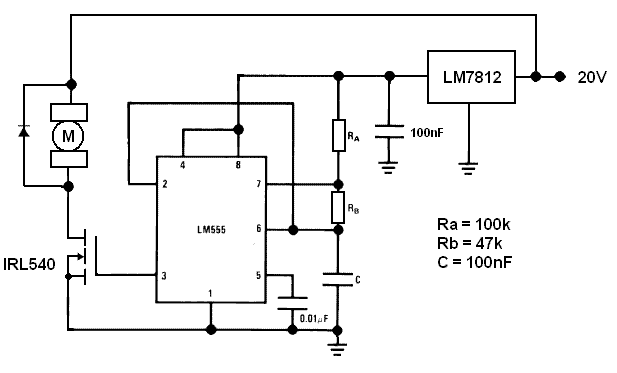

You could PWM the motor at 60% duty cycle.
The adaptor can probably handle 1.4A surgers at this duty cycle so it wouldn't be a problem.

Hero, thank you for the effort of creating a circuit. I guess this is the implementation of your earlier thought, "You could PWM the motor at 60% duty cycle." I'll build the circuit during the coming (North American) winter; earlier if I must. I see the famous timer chip, but I do not yet understand PWM. Is there a good website or book that you could recommend?
https://en.wikipedia.org/wiki/Pulse-width_modulation
My circuit turns the motor on and off at quite a high frequency. I've designed the circuit so that for 60% of the time it's on and for 40% of the time it's off so the average voltage across the motor is 12V.
This circuit is not recomended for active loads, i.e. things with transistors like radios or digital circuits, because the peak voltage is still 20V which you blow sensitive components, it should only be used for non active loads like motors and light bulbs which are fine providing the average voltage is within their rating.
