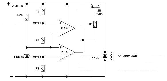

Could someone please help a muddled beginner with a window comparator circuit design?
See attached. It is a composite of several designs.
The IC1 is an LM393.
The relay will control a 115VAC, 0.5A motor. I liked the T77S1D10-12 relay: 10A and 12VDC and 720 ohms.
The resistors are 5%, 0.25 watt.
The range of temperatures when the relay should be closed (i.e., when motor should be on) is 43° Celsius to 74° Celsius; that corresponds to an LM335 range of 3.15V to 3.45V.
I have several doubts.
1. The LM335 datasheet says, "Operates from 450uA to 5mA." Is the 8.2K resistor correct?
2. As configured, will the LM335 feed both halves of the IC1?
3. What values of R1, R2, R3 give Vref1 = 3.15V and Vref2 = 3.45V? Could you show me how you calculated them? Should the R2 be a trimpot?
4. The T77 comes in 3A and 10A varieties, same price. Is there any downside to using the 10-amp version for a 0.5-amp motor?
And then, what feels like a difficult question.
5. The relay is good for 200,000 operations, so I'd like to add hysteresis. How do I add hysteresis to a window comparator?
Thank you very much for your help.
8.2K will give about 1mA which should be fine.
Yes.
If the required accuracy of your setpoints is better than 5% then you need a trimpot. If so, then you should break the divider into two separate dividers (2 resistors and 2 trimpots) so you can adjust each setpoint separately without interaction.
Also the accuracy of your setpoints depends upon the accuracy of the 12V supply. For good accuracy you would should add a reference voltage to supply the resistor dividers.
No downside unless the 10-amp verison requires more coil current.
You would add resistors in series with the positive input and then resistors from the output to each positive input.
There is a fundamental problem with your design. The polarity is such that both comparator outputs are high (relay off) in the window and the relay is on outside the window, the opposite of what you want. To correct this, replace the PNP with an NPN transistor. Connect the emitter to ground with the relay connected between +12V and the transistor collector. The transistor base would go to the comparator paralleled outputs with the 1k going between +12V and the transistor base.
The 1k resistor used to turn on an NPN transistor must be 2k minimum because the minumum output current of a low power LM393 comparator is only 6mA.

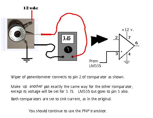

"If the required accuracy of your setpoints is better than 5% then you need a trimpot. If so, then you should break the divider into two separate dividers (2 resistors and 2 trimpots) so you can adjust each setpoint separately without interaction."
I'm having a hard time visualising this. Would anyone have the time to provide a quick sketch? What size are the resistors? What size the trimpots? Where, relative to the connections to the IC?

You could use potentiometers to set your window limits as the attachment suggests. My calculations show a 20k pot for each comparator should do the trick. If you try this, however, be sure to use the PNP transistor, since both comparators, as in the original circuit, are sinking current.;)
Questions?

Crutschow already explained why the PNP won't work, and he explained how to connect an NPN, which will work.
Thanks, Allvol, for the sketch. So, it's simple: 20K variable resistor and attach the wiper. Easy when you know. Thanks also for reinforcing how to check for the variable voltage on a live circuit.

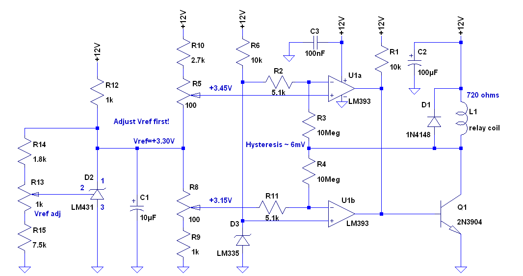

If your +12V supply is regulated, you should be able to use the circuit below.
Some of the members will say that this is a typical over-designed Roff circuit, :rolleyes: but it should be super-stable, and the upper and lower threshold limits do not interact.
If +12V is not regulated, we might have to make a small change.
EDIT: Oops! Forgot a resistor.
Yes, 12V supply is regulated. Is this in aid of the double hysteresis?
No, it relates to using +12V at the top of R10. This voltage needs to be stable in order for the upper threshold to be stable.

Now, about the part of the circuit over on the left, around the LM431? What does that do? It looks like it's a regulator similar to an LE33CZ, but there must be a reason why you didn't use a "canned" solution.
Wow, Ron, I can follow that! Thank you for your efforts.
You could use LE33CZ. I wasn't aware of it. The 3.3V reference is halfway between your upper and lower thresholds, and provides a "stiff" voltage to tie the pots to, giving you lots of resolution on the adjustments (each pot has only 300mV across it) and very little drift due to the temperature coefficients of resistive dividers (which you would otherwise have) and potentiometers.

It will be built as specified, substituting only the LE33C for the LM431 subcircuit. Do you have time for three hopefully final questions?
I've never encountered a circuit with a 100 ohm trimpot before; and here, at R5 and R8, there are two. You can probably tell that I cannot count voltage drops yet. You did mean 100 ohm, I hope, and not 100K ohm?
The minus on C2 should be a plus? And C1 doesn't seem to be attached, was it supposed to be part of the LM431 subcircuit?
And thanks, Ron and all.
Ron,
You are having a problem viewing the schematic. There is nothing missing when I view it, and there is a plus sign on C2. Can you click on the schematic and make it larger? If not, your monitor must be low resolution or something.
The pots are indeed 100 ohms, not 100k. It is a common value.
