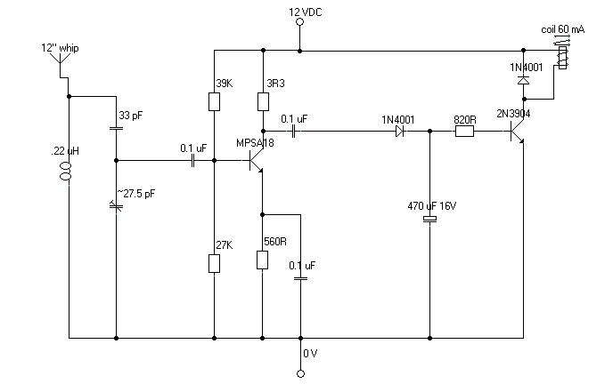

Please could someone clear up a doubt about transistor biasing?
The "receiver" in the attachment is listening for a 1kHz square wave at 87.5 MHz FM. From the US FCC regulations, the incoming signal strength should be about 0.2 mV and 50 uA.
The MPSA18 amplifier has Vbe(on) = 0.7 VDC and hFE = 400. I used one of the on-line "voltage divider biasing" calculators, to convert the MPSA18 characteristics into the 39K/27K/3R3/560R values.
Here's what I can't see. The R1/R2 voltage divider give 4.6 VDC. If so, is a biased transistor's voltage always on? And if so, is the meagre 0.2 mV from the antenna irrelevant?
If a transistor is a current-controlled device, is the current through the potential divider more than enough to keep the MPSA18 permanently on? Should I calculate that as:
12 V / (39+27) KOhm = 180 uA?
And if so, will the 50 uA from the antenna make any difference?
How does this work? I'm missing something very basic and obvious.

The transistor will be turned on all the time, but as long as it never saturates, that is OK because variation in base current will cause variation in the collector current.
The 0.1 uF capacitor to ground makes the AC gain much bigger that the DC gain, but it is still tiny because the 3R3 is far too small. You should have more like 680R. Then the output swing would be a lot larger. If the input current is actually 50 uA the transistor will saturate some of the time because the output will be so big, but with say a 10 uA swing, the output voltage will vary by about 10 uA * 400 * 680 R = 2.7 V, which should turn on the next transistor.
You also need a diode from ground to the connection between the 0.1 uF and the diode that you already have. 1N4148 diodes have a lot less capacitance and will work much better.

For a transistor to amplify, it must not be turned completely off or completely on. The 39k/27k potential divider makes sure that the transistor is partially turned on.
If the voltage at the base of transistor changes, the voltage of the emitter will change by about the same amount. The change of current in the emitter depends on the impedance of the emitter resistor. At high frequencies the capacitor on the emitter makes the impedance of the emitter very small, so there is a large current change in the emitter current and therefore in the collector current. The change in collector current gives a large change in output voltage.
The extra diode's cathode connects to the anode of the diode that is in your circuit diagram. The anode of the extra diode connects to ground. The diode is there because you can't get current through a capacitor for longer than a very short time. When the collector of the transistor goes positive, current will go through diode and charge up the 470 uF capacitor. When the collector goes negative, there needs to be a path to put current into the right side of the 0.1 uF, and that is what the extra diode is for.

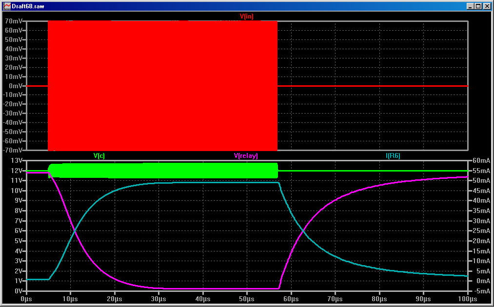

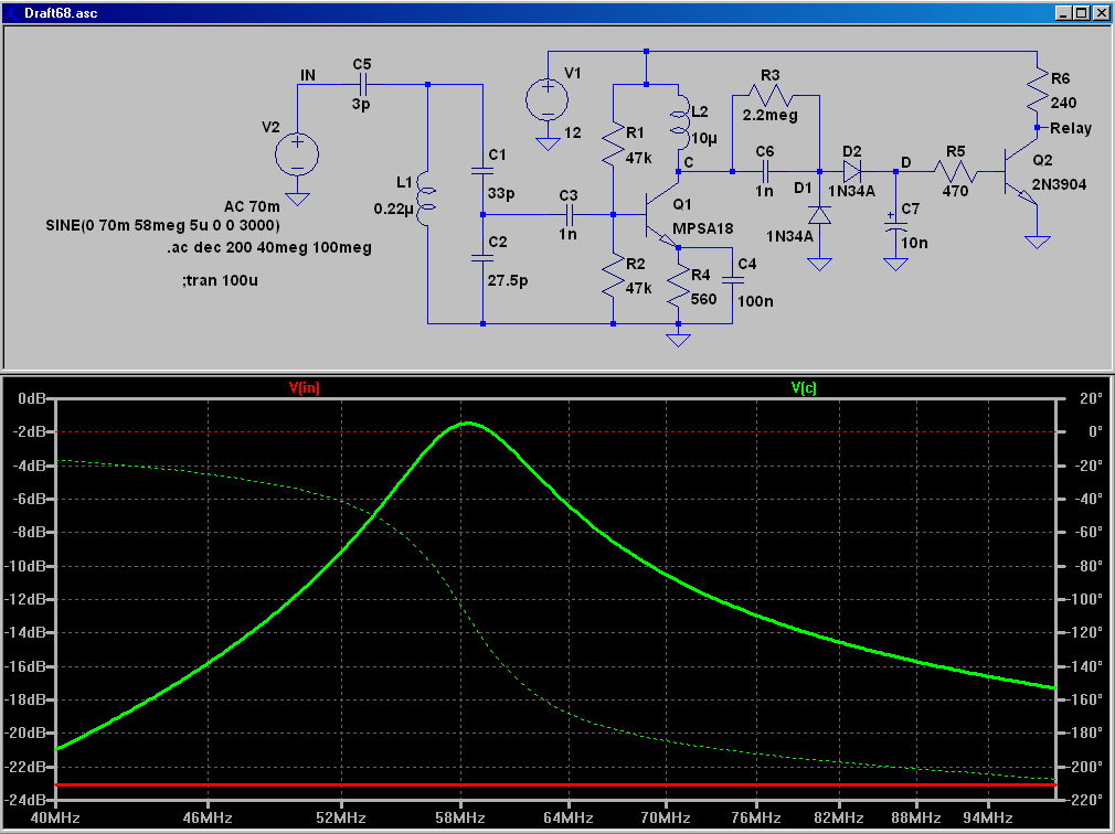

I came up with several improvements based on LTSpice simulation:
First, note that the resonant freq of the tank is ~58MHz, lower if you considered stray capacitances.
Second, by optimizing the bias and replacing the transistor load with a 10uH RF choke, I got about 10db more gain out of it. Note that the collector is now at 12V (Choke has ~zero dc resistance), and I upped the quiescent collector current. The transistor now has ~20db gain at the resonant freq when the input is +_70mV. See the ac sim, which shows the gain from the input IN to the collector C.
I used 1n34 Germanium diodes instead of Si diodes, with a bit of bias. This greatly raised the detection sensitivity. I optimized the coupling caps for appropriate time constants. The 470uF was too huge by several orders of magnitude. The time-domain sim shows the response at the RELAY to a 70mV, 58MHz burst, which is about the lowest amplitude that can be reliably detected.

In the simulation, the tank circuit is loaded by the extra 3pF I used to couple the signal in, and the input capacitance of the transistor, both of which add up to lower the resonant freq.
The problem with the 470uF is that it delays both the initial detection, and the decay after the signal goes away. You need some sort of fast attack, slow decay circuit. I would put a resistor pull-up in place of the relay, and then add the delay circuit downstream of that. A 555 would work nicely, and it can drive the relay if you really need a relay.

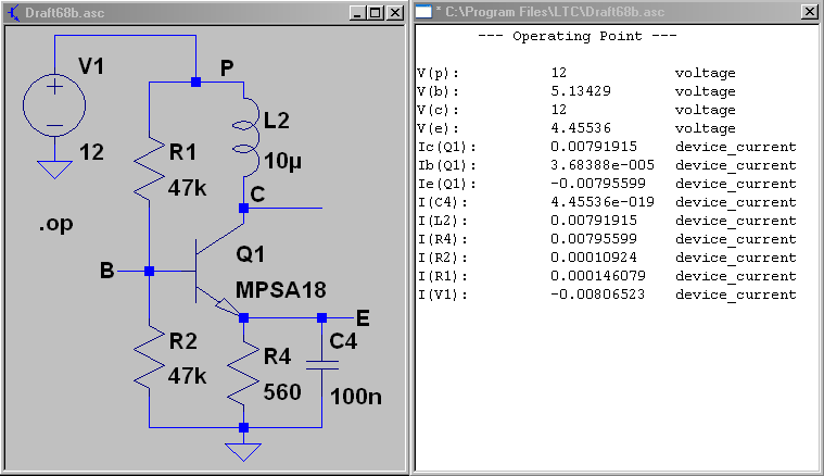

1. Why doesn't any of the current flowing down the (now) 47K / 47K voltage divider flow to the base of the MPSA18? Why doesn't that current swamp the meagre 50 uA from the tank?
Some current from the top 47k resistor flows into the bottom 47k resistor to produce the DC bias voltage and a very small current flows into the base of the transistor. It is the DC bias voltage and current that turns on the transistor a little so it is ready to amplify the AC signal from the tuned LC tank circuit.

1. I'm going to use the power of LTSpice to answer that. I isolated only the bias part of the circuit, and asked it to show all of the DC voltages and Currents (with no input signal). Note I(R1), I(R2), and Ib(Q1).
2. It is not the input capacitance of the resistors that matter, even though at ~100MHz they do exhibit some between their two ends. It is primarily the base to emitter and base to collector internal capacitance that shifts the resonant frequency. My little 3pF accounts for about half of the delta from 87 to 58 MHz. The rest is due to the transistor. When you build the circuit, the shift will be even worse, due to the stray capacitances of the wires, pcb traces, the bias resistors, the capacitor bodies, the coil turn-to-turn capacitance, etc. Hint, when you build it, you will need to reduce C1.

I see the very low Ib(Q1). And you've left enough hints to prove how it got so low.
