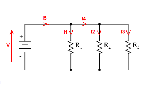

This looks like a great forum. I am just getting started and have a very basic question. I understand that the flow in a circuit goes from + to - but in looking at the following basic schematic I'm wondering why there is no current flow (per the arrows in the schematic) from points 2 to 7 and 3 to 6. Given the rule that the current will follow the path of least resistance I suppose that because resistors 1 and 2 sit on the path from points 2 to 7 and 3 to 6 respectively then the current doesn't flow down those paths. Am I correct in assuming that? So, for example, without resistor 1 the flow could go from point 8 to 7 to 6 to 3 to 2 then to 1 or 7 again. But if this is the case why does the schematic show current from 8 to 7 to 2 to 1 i.e. up through resistor 1? Thanks in advance.

Hmmm. Thanks for the response but my question is, in this circuit, why doesn't the diagram show flow from, for example, 7 to 6 to 3 to 2 and then back to 7 again? Why does all the flow in this diagram at point 2 go to pt. 1 and not to pt. 7? I know I'm missing some basic theory or the diagram is wrong but I don't know which. And. btw, your point about the conventional flow direction is well taken.
Why is there no current flow from point 2 to point 7 or from point 3 to point 6? Also, why is there none from point 2 to point 3 or from point 3 to point 4?
Referring to my modified version of your diagram shown attached.
I have used conventional current notation rather than electron flow as used in the original diagram.
The source of voltage is connected to three resistors R1, R2 and R3.
The voltage across each resistor is the same, the connections are very low resistance, we can neglect this resistance.
A current flows through each resistor, I1 flows through R1, I2 through R2, and I3 through R3.
Using ohms law, I1 = V/R1, I2 = V/R2 and I3 = V/R3.
I4 = I2 + R3, I5 = I4 + I1 and I5 = I1 + I2 + I3
There are three individual currents I1 I2 and I3 in the three resistors, each of these currents flows from the battery (voltage source), through the associated resistor and back to the battery.
In the connections between the resistors:
Between R2 and R3, the current is simply I3.
Between R1 and R2, the current is I4 = I2 + I3
Between the battery and R1, the current is I5 = I1 + I4 = I1 + I2 + I3
I hope this description helps.

Given the rule that the current will follow the path of least resistance**broken link removed**
Wrong, there is no such rule! The current divides proportionally to the inverse of the resistance of each branch. If you believe in Ohm’s law “I=E/R” then you cannot believe in you statement that the current follows the lowest resistance path. Also, engineers use conventional current flow because it makes the arithmetic come out right, technicians use electron flow because that is the way the universe actually works. Technicians mostly hang out in this forum so be ready to reverse your thinking depending upon who answers a question.
While I agree that you should go over Kirchhoff’s law, the important thing in this case that current can only go in one direction in any device. If it is flowing up in R1, it cannot also be flowing down in R1 at the same time which is what you imply asking about 7 6 3 2 7 path given the 1 8 7 2 1 and 1 8 7 6 3 2 1 paths.
