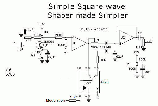

Thats excellent, should be fine for the job then. Ultimately, I am aiming to build my own analogue modular synth, utilising that Moog filter and ring modulator, but this is for part of my custom oscillators. If you look here:
http://www.geocities.com/tpe123/folkurban/fuzz/snippets.html#lofomofo
On the project titled simple square wave shaper made simpler, I intend to use the JFET in series with one of the 500k pots next to the diode. Can its resistance be lowered to absolutely nothing, or very near to, btw?
Hi Dr. EM,
You do like to listen to square-waves! :lol:
The pots in this circuit have a signal at each end and therefore it would be very difficult to bias a JFET to replace one.
An optocoupler can replace a pot in this circuit, like a 4N26. An H11F1 opto-FET might be better. They would go down to about 330 ohms.

:lol: well basically, I don't want to limit its range too much. What I really need for it to do if vary its resistance rapidly by about 100k, as I remember, when I set one control about to max, and the other to midway, when i swept the middle control back and forth fast, it sounded nice 8):lol:
I can get a 4N25 over here. I didn't know an optocoupler could be used like this. So, how would I connect it up? If all else fails, it'll have to be a CDS cell and and LED with a bypass switch, though this is slow and not very variable. Thanks for your help so far btw!
Hi Dr. EM,
A 4N25 has only 20% the transfer ratio of a 4N26, so it needs a fair amount of LED current. It should work fine if the modulation input swings a few volts positive, in my modified circuit. I changed the diodes around in the circuit to make it easier to sketch:
