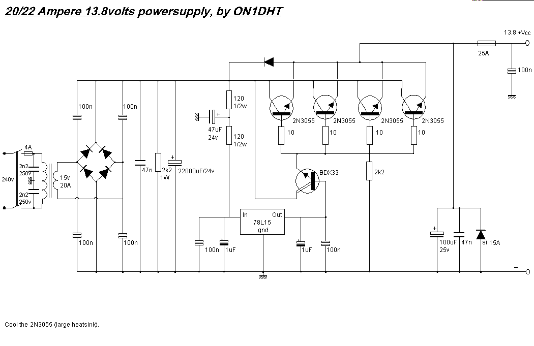

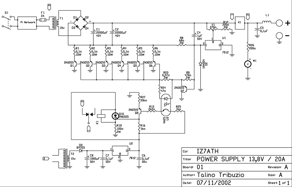

There are lots of them on the net, here are some.
Ante :roll:
