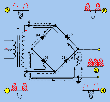

Take a good transformer with a voltage output of around 20 or enough to power the max DC voltage you want.
Then make a bridge rectifier using 1N4004 (I recieved 500 for FREE so I use those always)
Put a large cap across the + and - terminal so it smoothes it out.
Put a bunch of V regs on it (3.3, 5, 8 or 9, 12) and make sure you throw a bunch of caps on the whole thing.
Add a fuse here and there to protect over amping the thing
There you go it should work in theory :)
