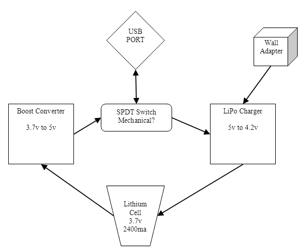

I have an idea for a portable power source, designed to recharge devices that will accept a charge over the USB connection.
The heart of the system relies on a single cell boost converter, powered by a lithium cell, converting the lithium's substantial current into +5v.
To make the device super flexible, I also plan to incorporate a USB powered lithium charge controller, so the unit can recharge itself from any usb host (laptop, desktop, etc)
To keep things user friendly and 'simple' on the outside, I would like to use the same USB port to both receive power from the host for the lipo charging circuit, as well as provide power to a device from the boost circuit. I would like to make this as automatic as possible.
I know a simple single pole double throw mechanical switch would work here, diverting the +5 line from the usb connector to the charger or the supply ... the question is what is the best way to replace that switch with something electronic?
What I'm trying to figure out, is how to sense the difference between being connected to a host (source of power), and being connected to a device (load). To keep things simple, I want to avoid the software side / usb stack by all means.
Right now I'm working on the assumption that a proper device should never source current, where as the host will gladly source current.
Does anyone have some ideas?
I have attached a crude block diagram of the proposed setup.

The problem I keep running into however, is the dual purpose for the single USB connector ... needing it to automaticly determine if it's sourcing current (powering an external usb device) or sinking current (recharging internal battery)

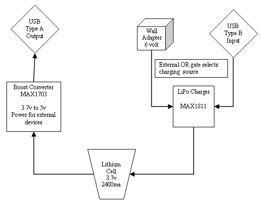

I'm thinking right now about using the MAX1811 as the charge controller, 500mah charge current should give approximately a 5 hr recharge time with a 2400mah cell.
For the boost converter, either the MAX1703 or the MAX1675 ... I need to look at the current draw of some typical loads ... the 1675 offers a maximum of 300mah output with a limit of 500mah switch current, the 1703 offers a maximum of 1.5a output with adjustable switch current upto 1a.
max1675:
max1811:
max1703:
I've attached my revised block diagram.
