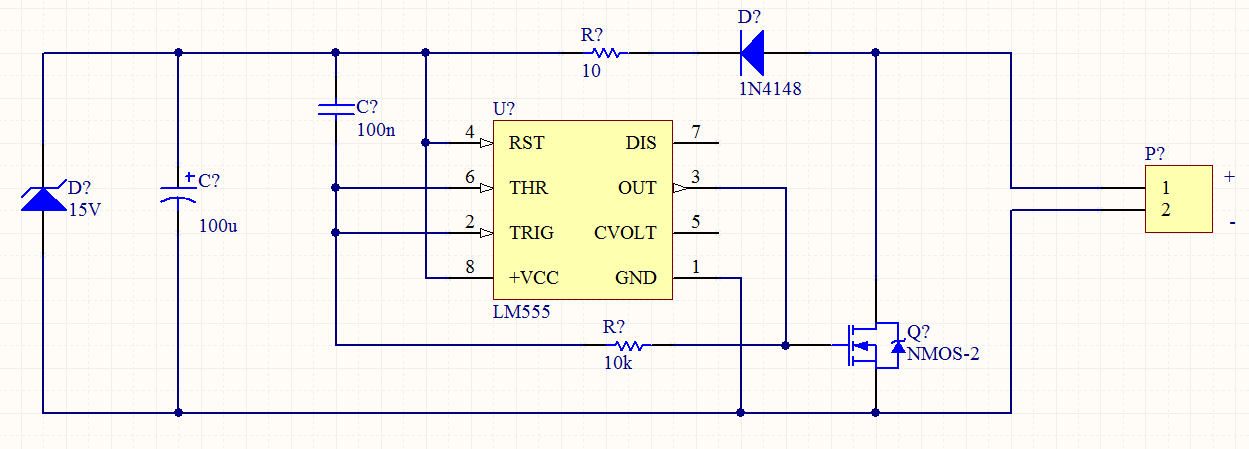

Here is a pic of the schematic I have come up with and I currently show a spot for a resistor to reduce the 12v to 6v which I would like to change to something else. The brown (left side lights) and violet (ride side lights) wires are the wires feeding the rear tail lights to the right of the diagram that I do not show. You can see that feeding into those wires is the running light (blue), brake light (red/yellow) and the turn signal (brown or violet depending on which side of the bike). I want to add connectors as shown which will make this a plug n' play type system. Any feedback is appreciated:
I figure the easiest option is adding a resistor but don't like the idea of the heat generated to do this.
The PWM method is good; have a look at the schematic I've attached. It goes in place of the resistor; if connected the wrong way, the light will be nearly full on, if connected the correct way, the light should be half on.
