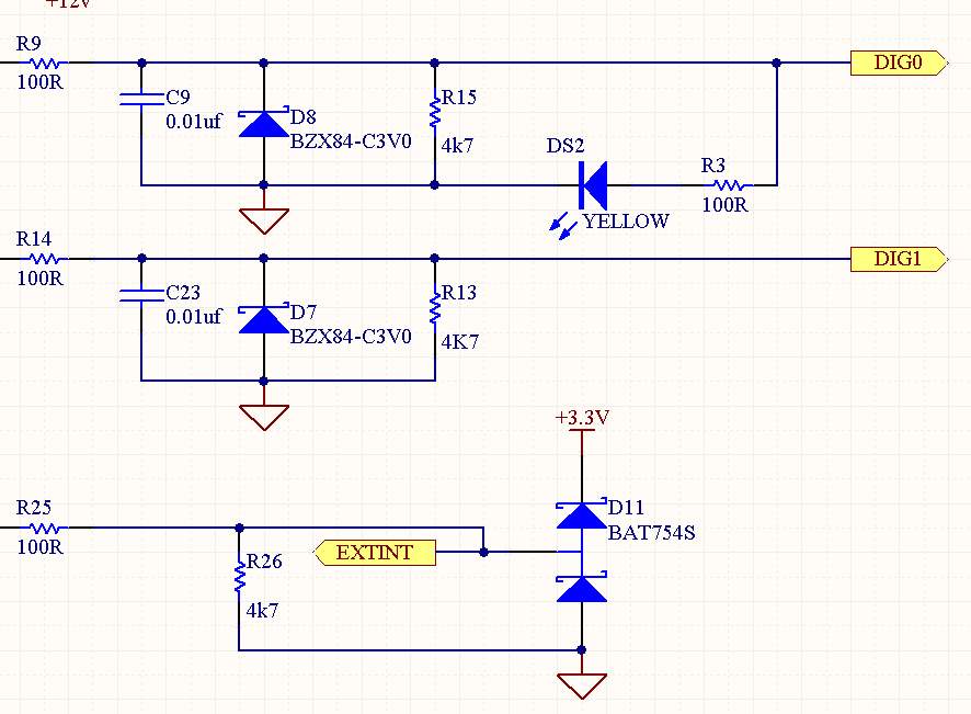

I want to protect some digital inputs going to a Atmega128, I don't really need opto-isolators but I do want some protection.
I have attached a schematic I found with protection but I'm not really sure if it's correct and why there is a difference?
Anyone help with an example?
P.S. It's for a automotive application so voltage range is 12v-30v and a possible high current supply.

Hi Scarr,
A 3V zener diode makes a lousy voltage regulator or voltage clamp.
On its datasheet, a BZX84-c3v0 has a max differential resistance of 95 ohms at 5mA (less for your higher current) while a half-decent BZX84-C6V2 has a max differential resistance of only 10 ohms at 5mA.
If the input voltage is 30V, more than 200mA will flow, much more than a little BZX can handle. Whatever amount its differential resistance is at more than 200mA, its voltage will certainly be much higher than only 3V.

In automotive designs First we try to limit the current through input port
The input ports of the microcontroller normally hav parasitic or intentionally developed diodes to VCC and GND at the inputs which are limited by current rating
So we try to keep the current below maximum even if the voltage is above rating
In our circuits we apply 16V through a series resistor directly (without any zener clamp) to the microcontroller

I don't have any of my literature out to look up the diode types shown on the schematic provided, but the symbols drawn are for Schotty (hot carrier) diodes, not zener diodes. As such, in the first two circuits, they limit excursions of the signal to around -0.1 or -0.2 volts with no limit in the positive direction. In the second circuit, they clip the signal if it exceeds the window of -0.1/0.2v to +3.4/3.5v. Actual voltage depends upon the current through the diode, and for low currents on a hot carrier diode, the voltage drop will be quite low, around 0.1v

There are lots of helpfull comments, from what I can see is (and please correct me if I'm wrong) that simply using a larger series resistor will suffice?
How can I calculate the correct vaule for this resistor given that the voltage range is for automotive use (absolute min 6v - absolute max 40v)?

Assuming Atmel have diodes to Vdd and Vss like a PIC?, a resistor should be all you need - no need to calculate anyhting really, stick a 100K in place!.
If you want to work out the minimum value it can be, then check the spec for the protection diodes on the datasheet - this will give their maximum forward current. Calculate the voltage drop across the resistor, apply ohms law, and you have the minimum value. But 100K is going to be greatly higher than the minimum, and should be no problem as it will limit current to well below permissable levels.

To calculate the value of resistor you normally need the maximum current rating of the input terminal which in most cases is not normally specified in the datasheet.
So you will have to contact the manufacturer for the same.
The value of resistor
Minimum - Maximum VB / maximum current rating
Maximu - Leakage current * Max resistance < Vil max (maximum low level input detection voltage )
