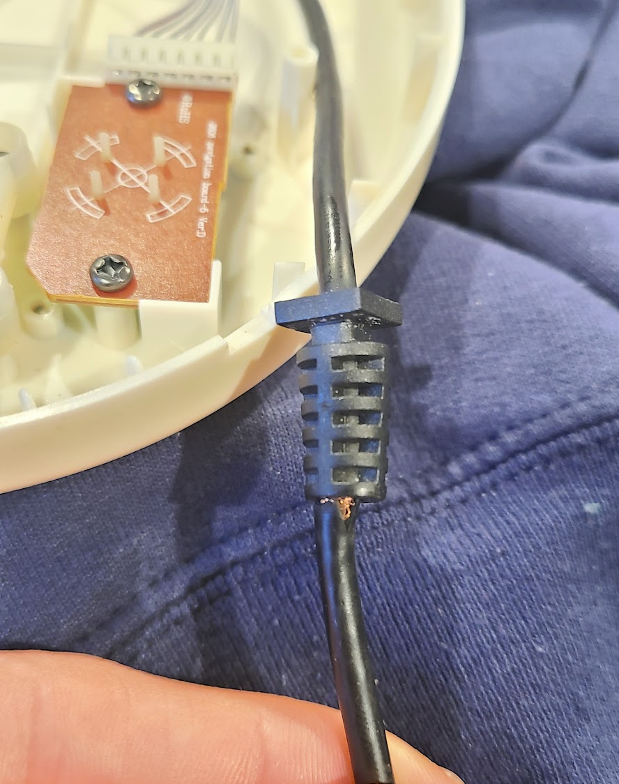

Hi, I have a small electronics wire that I believe is shielded with copper. The strainer where it wire enters is frayed (see photo below), and I can see the copper. The strainer is molded into the cord. I was wondering what would be the best way to fix and strengthen it. I was thinking of just using liquid tape to seal it, but then started thinking it would still be weak. This is on an electronic toy guitar, so its going to get flexed.

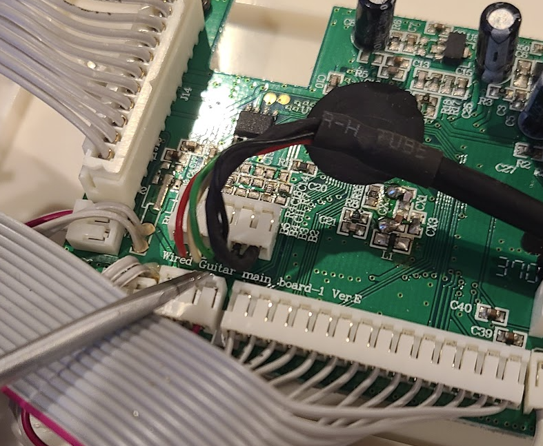

Also just out of curiosity, wondering if at the end of the wire (see 2nd photo by screw driver tip), that copper I can see by the strainer is that black taped wire at the inside pcb board. Also show are 4 wires (Red White Green Black)
This is the other end of the wire, inside the guitar.
Possibly some high-shrink (4:1) adhesive lined heatshrink tube, if the connector at one end is small enough to go through that. It will massively reinforce the cable at the weak point and provide a longer strain relief. I've used that on laptop power connectors that have started to fail in a similar way.
Another temporary repair option that can work well is to build up some self-amalgamating tape over both the strain relief and first two or three inches of the cable, building it up to make a larger and longer tapered relief. It forms one solid mass of rubber over a few hours and stays flexible.

The ultimate answer is to replace the cable. It's four core screened, with braid screen wires twisted together and in some small heatshrink, from what I can see in the photos.
It is sometimes possible to separate those moulded on strain reliefs from the cable outer by working a jewellers screwdriver in between them & working around the cable.
A longer, more flexible strain relief will work better. The short moulded ones still mostly cause the cable to bend at the end of the relief, rather than spreading the bending over some distance.

It's not they did not use the right material, but rather the wrong design for the material of the plastic shroud. Here they made it very flexible with ribs but then had an abrupt stop at twice the cable diameter with more than twice the stiffness.
The criteria I use is that the strain relief must create a bigger bend radius than the cable (stiffer) yet taper down to almost the same diameter as the cable. This taper length needs to be at least 5 times the cable diameter. The plastic needs to be durable with high adhesion to the jacket. There is a rubber-like dip chemical that is fairly flexible and needs to be thick but looks great with a gloss black.

This looks bad enough to me where I would redo the entire thing. That means cutting the cable then stripping the wires back to bare wire, then reconnecting them and then covering with heat shrink or something like that. That's the only way to be sure. The only catch is that you have to place the heat shrink on the cable and/or wires before you solder them back together, and be careful not to partly shrink the heat shrink tubing until after you are done soldering and can slide the heat shrink tube over the joint properly before shrinking with a hot air gun (soldering irons suck for doing that).
