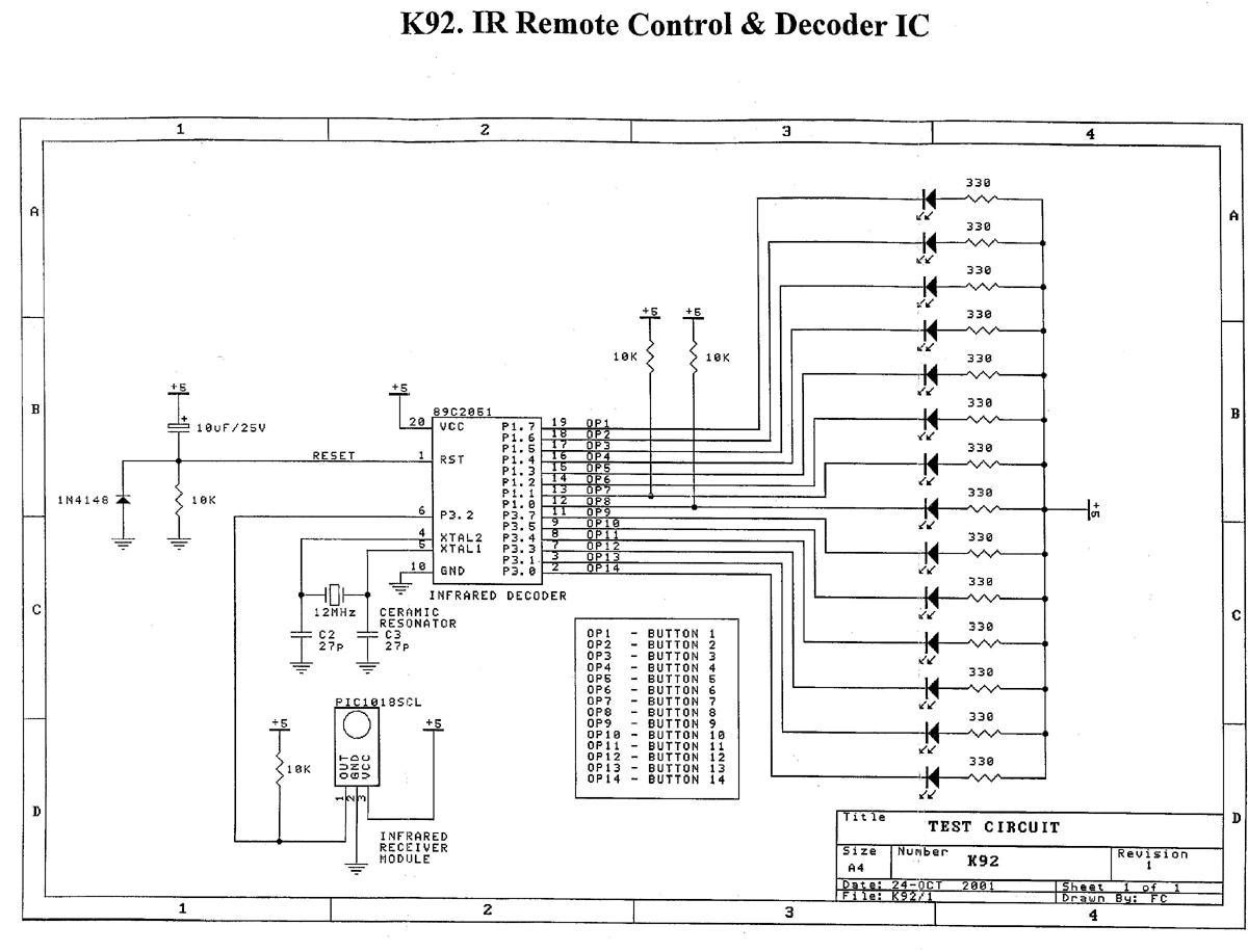

heres a better fic of schematic
anyone know if there is a way to reverse the normal high to normal low
thanks :idea:

Since it is 5V, you can use a 7404, otherwise, how about just modifying the software to invert the signal for you? (unless you dont have the source).
