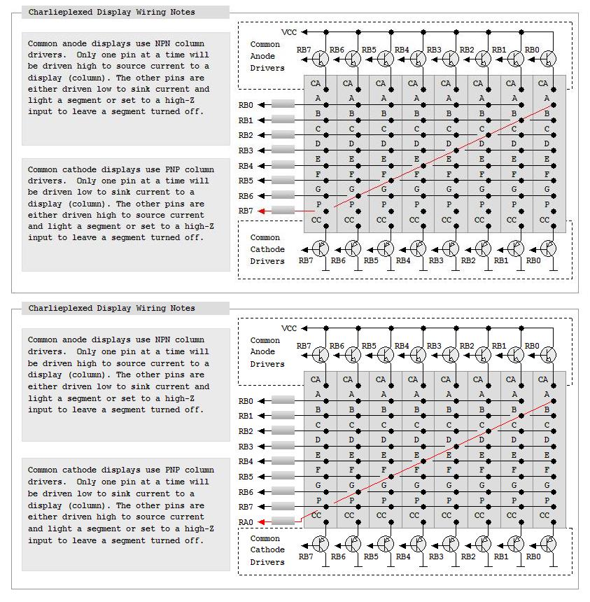

Hi Mike
I must be missing something, but it seems from the schematic that you use same port to drive digits and segments of your display. I believe it can be done by using latches, but I do not see anything like that. Can you please explain how it works?
Thank you Jirka
Google "charlieplexing"..... (also sometimes referred to as N(N-1) multiplexing).

The display wiring is a bit complex compared to traditional multiplexing but the code is probably not as complex as you might imagine. Once you grasp the tri-state requirements and that "float" pin concept the ISR driver code is pretty simple and straight forward. I've seen more complex driver code for standard multiplexed displays in some tutorials.
This example ISR driver for an 8-digit Common Cathode display using 1.0-msec Timer 2 interrupts (12.5% duty cycle, 125-Hz refresh rate) uses about 5-usecs "overhead" every 1000-usec interrupt (0.5% driver overhead);

How come this design uses RB0 to RB7 to turn on the segments and also used them to select different 7-segment display?
That particular reduced I/O display multiplexing technique is called Charlieplexing. Here are the 8 pin (no decimal points) and 9 pin version wiring notes;

charlieplexing!! I thought it is the same as multiplexing.. we need to send the signal to one port only for displaying eight 7-segment displays right? That's smarter than multiplexing.
Can't I use PNP for common anode, can I?
EDIT: Can I still use the look up table if I use charlieplexing? The pattern for displaying the same number for the different 7-segment display seems to be different.
Charlieplexing is multiplexing, it just uses a more complex scheme which requires fewer pins than common multiplexing techniques. Look it up in wikipedia. And no, your lookup tables would require at least software conversion into the charlieplexing pattern. The diodes have to be able to withstand being reverse biased at the controllers driving levels though.
