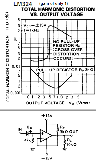

Really it was only ever of use on one specific opamp (or series of opamps), the LM324 if I remember correctly? - I've no doubt Audioguru will remember and correct me?.
To reduce power consumption the output stage was run in class B, so you got cross-over distortion - by forcing the output stage to be single ended, you got a low power, less distorted opamp. However, far easier to use a better opamp in the first place!, and probably better performance as well.
The old LM324 quad opamp was the first low-power opamp. They reduced its supply current by removing the bias voltage between the output transistors so they operated in cutoff for the middle 1.2V of a signal. The crossover distortion is horrible. Negative feedback doesn't help much to reduce the distortion because the low power opamp has poor high frequency response.
Adding a DC load allows one output transistor to operate in class-A.
The distortion is 3% when it has 100% negative feedback reducing it.
The distortion drops to 0.0018% when the output operates in class-A:
