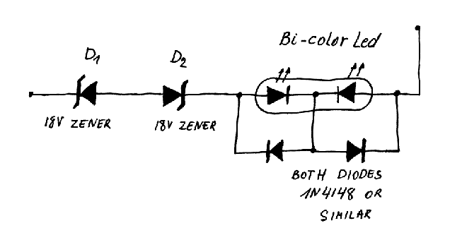

Here's a neat dual color trick for you. How do you control a dual color LED with a single digital output?
You connect the resister to the LED on the common lead. This wiring only allows one color to light at a time, if both colors are powered the one with the lower forward voltage wins.
Do either a quick experiment or take a quick look at the LED's datasheet to figure out which color to power with the system on and which will be switched on and off.
