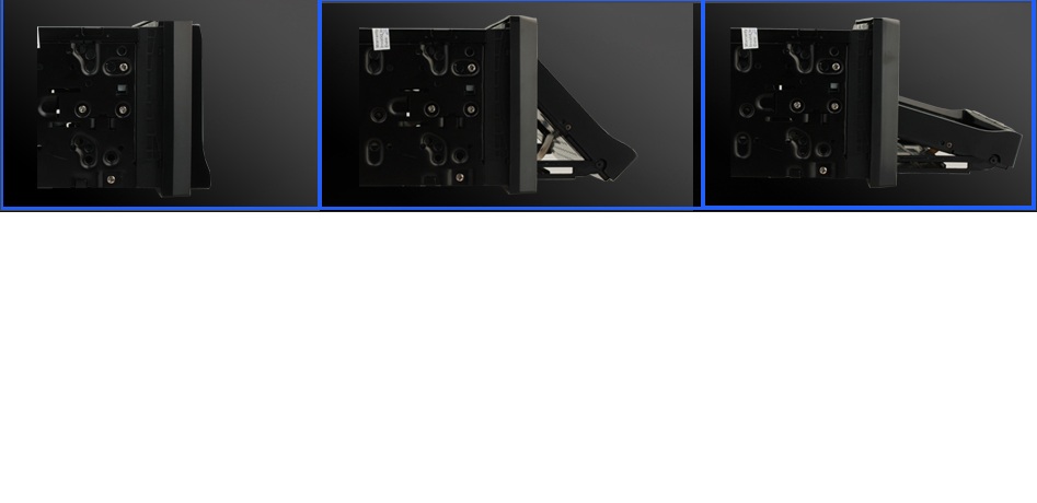

I want to control a car DVD player screen - its a motorised screen which slides out (see pic).
Its run by a 9v motor (ff-180sh-14240)> not sure of the current it drags. Tested it with a 9v battery and works fine
So what I want to do is:
There are 2 switches (microswitch) to detect when the screen is its neutral position (i,e fully verticall) and one when it fully folded out.
1. There one button to control the screen i.e motor.
initially the screen is in its neutral position i,e fully vertical
2. If i press it for a short period of time the screen moved a bit out (i.e the motor rotates a small amount). I can repeat this till i get the screen to a position i like or maximum open position
or If I hold down the same button for a longer period of time (lets say 3 seconds) the screen slides out to its fully open position.
4. This position is detected by a microswitch which switches on. This allows the motor to move in the reverse direction when the button is pressed again -->
4. While in the position if i press the button again the screen moves back completely to its vertical (neutral) position.i.e the motor moves in reverse. It know its at the neutral position as it switches on a different switch
heres a pic of the screen positions.

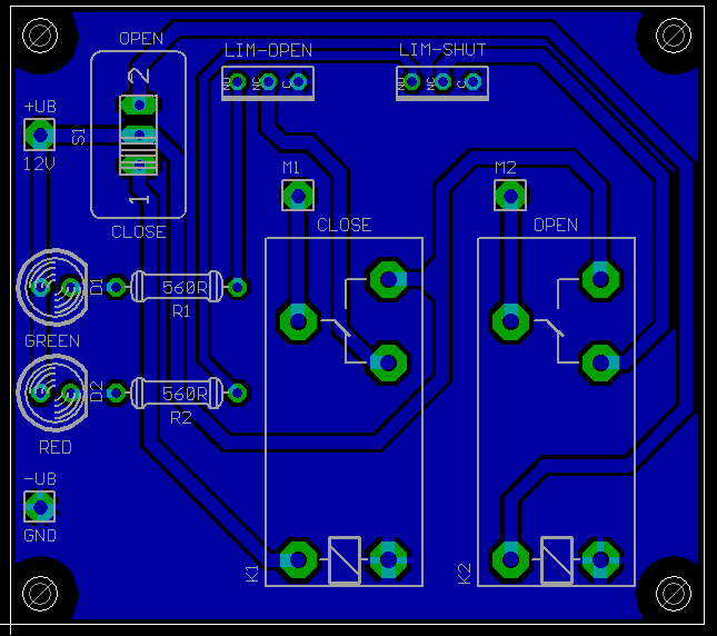

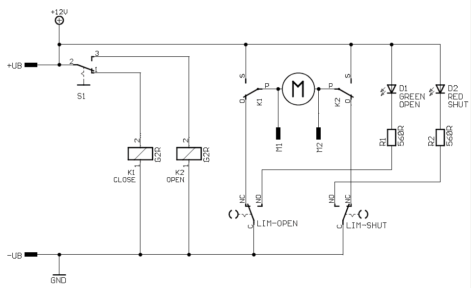

Here is a simple circuit suiting your needs.
Nothing can go wrong using relays and limit switches as drawn regardless of the switch position.

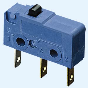

Limit switches are micro switches as shown in the attachment.
If the switch is in the "open" position the motor will rotate until the limit switch interrupts the ground path. Simultaneously the "open" LED will be lit. The same will happen in the "close" position with "shut" LED lit.
Since an SPDT switch is used you should avoid reversing the motor while your device is moving. Reversing the motor at full speed results in a momentary stall with high current flow.
You are welcome to obtain the Eagle files via email PMing me your full name and email address.
Boncuk

Hi
I sort of understand how its reversing. Whats K1 and K2 if i'm using a SPDT switch? Also this seems to be a 2 switch porcess as s1 has ?2 positions - not a simple push switch
Also i'm trying to move a 9v motor - not sure if this is suited for 9v motors

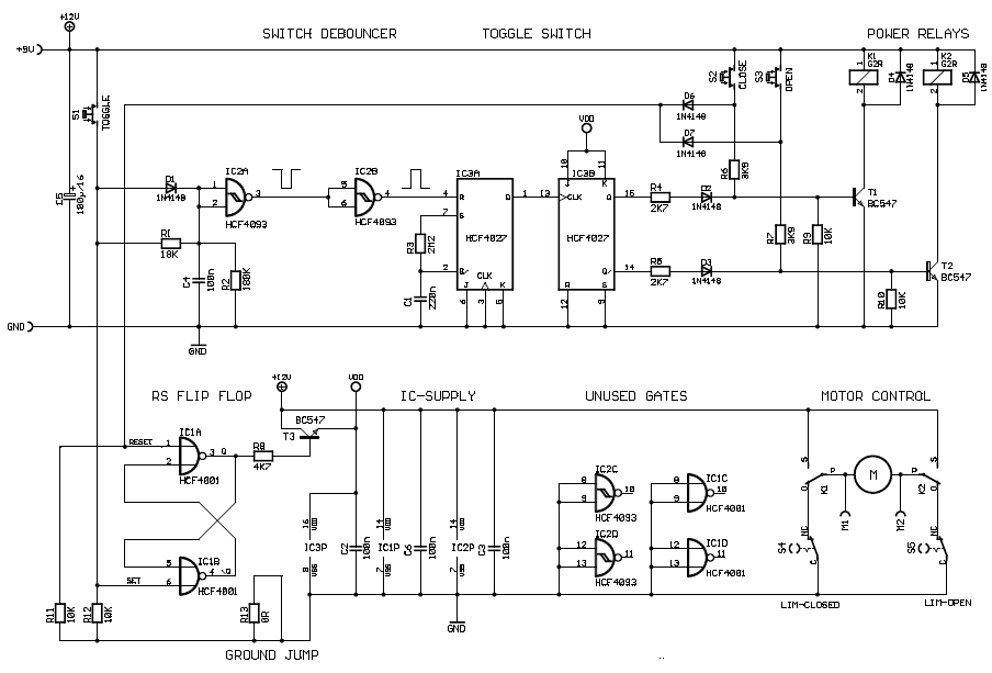

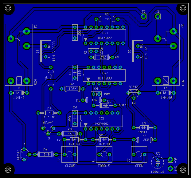

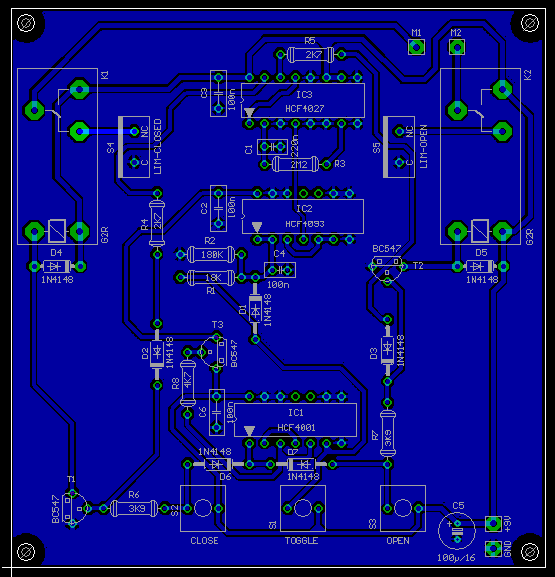

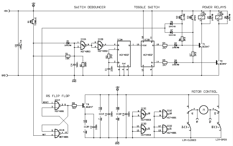

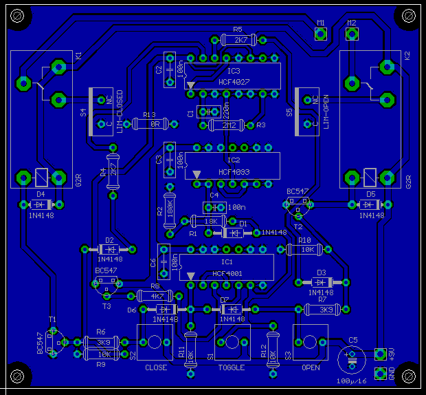

Hi chaminda,
I changed the design according to your desire.
Here is the result. BCB size is 3.3740X3.6375".
The circuit has not been tested!
Use adequate filtering when using the circuit in your car. Car alternators provide pretty "dirty" DC!
Boncuk
P.S. The second layout is revised for a smaller board, now measuring 3.4750X3.2125"

Hi chaminda,
how do you "tell" a relay to close contacts for a certain operation and deactivate it with a single switch?
The solution I offered is error free (after revision) and requires push buttons only.
You have all choices you wanted:
Open and close fully when pushing one button alternating, open and close partly pushing one of two more buttons.
I guess you haven't made up your mind about what you really want.
Furthermore I haven't stolen my time to help somebody who can't decide what he wants.
