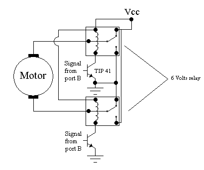

hi all,
i've built this circuit to control the DC motor in both direction. It works well. can anyone tell me is there anything need to be modified?
i've tried using other transistor, 2N3904. but it can't switch. only this TIP41 can switch the relays.
The base of the transistors go to the uC.
00--> forward
11-->reverse
10/01-->stop

Depends on the spec of the relays, however you don't show diodes across the relay coils?, these are ESSENTIAL!.
essential!?!? i didn't know that? why is it needed? can i use 1N4148?
then how about the transistor? can i use other value since the TIP41 is very big.
A 3904 might be able to drive the relay coil, look at thier resistance and use ohms law to find how much current they need, then see if its within the limits of the 3904 (which I think is around 100ma ?). 4148 diodes are signal diodes and arn't really the most suitable. 4001 (or 4002, etc) are cheap, common and are much more suitable. They need to be there to absorb back emf from the relay coil when it is de-energised, this emf can otherwise damage the transistors (check the 3904s you used for damage).

When the current through an inductor (like a relay coil) is turned off, you get a large (100's of volts) reverse spike as the magnetic field collapses - this is called the 'back EMF'. This spike will destroy the transistor feeding the relay, so you place a reverse connected diode across the coil, and this prevents the spike causing damage - a 1N4148 should be fine for your relays.
As suggested, if you've tried smaller transistors they have probably being damaged - the much larger TIP41 has more chance of surviving.

Each relay only has one coil?. Check my PIC tutorials, the hardware extras section shows how to wire a relay from a PIC.
so if i use tip41, do i still need to use diode? or i need it for safety.
You ALWAYS need a diode! - there are other methods, but for your purposes ALWAYS USE A DIODE.

Here's my basic explaination of back EMF.
When you expose a coil to a sudden change in magnetic flux (feild) a voltage proportional to the rate of change in flux is induced in the coil. This is exactly what happens when you turn your relay off, the magnetic flux surrounding the coil suddenly disappears inducing a huge voltage spike in the coil which can damage any semiconductiors driving it. An easier way of understanding is that the relay coil is and inductor and inductors try to resist change in current flow, so when you disconnect the power it tries to keep the current flowing therefore generating a high voltage.
How do we solve this problem?
We add a diode in reverse parallel to short circuit it.

as current flows through an inductor , it create a magnetic field around it, when the current stops , the magnetic flux should also stop . so it starts reducing its strength , and u may remeber a conductor in changing magnetic flux causes electric current which depends on the rate of change . so a sudden collapse of magnetic flux creats a high voltage , in this case towards the collector. the reverse parallel diode starts conducting once the voltage across the the coil reaches say 0.7V and never allows to rise above that , protecting the collector.

Because it's trying to push the current through an open circuit, this causes in theory an infinite voltage to be generated, in practice it's between 200V and 2kV and depends on the nature of the coil.
so, u mean the spike will go up to only 0.7V because of the diode right? then the 0.7V won't affect the transistor, right? can a capacitor do this? touch a capacitor between one end of the coil and the collector to the GND.

Yes, 0.7V is far too small to cause any damage.
It depends on the size of capacitor and inductance of the coil, capacitor in paralell with form a tuned circuit, the curent in the inductor will charge the capacitor, when it's fully charged it with then discharge back into the coil, this oscillation will cary on until the energy is disipated by the resistance in the circuit. It will only help the capacitor is large enough to absorb enough current without charging up to a dangerous voltage, this might not be practical since it might need to be so large that only an electrolytic will do which is no good since it's polarised and cannot safely charge up in reverse. A capacitor is only normally used when the relay is powered from AC and a resistor is often added in series with it to help disipate the excess energy enabling a smaller capacitor to be used, this arrangement is often called a snubber network.
