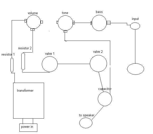

hi, i am looking to make an amp head for a 16 ohms speaker in an amp cab i made. i dont know anything about electronics but when i get decent plans i can easily follow them and put it together (its something i was born with i think :p ) (plus i have a freind doing electronics at university whos coming back soon and im gonna get him to give me some pointers)
i am looking to make a valve amp with basically just a volume switch, treble and bass. i would also like maybe a tremolo but that might asking a bit much.
anyways, ive had a good search around the internet and found hundreds of plans but there all to complicated for me. what i was looking for was a plan that has the curcuitry set out as if it were just a drawing of what the inside looked like in real life with just some markings on it like, what the valves are and where they connect to, things like that. i have attached a rubbish picture i drew to give an example of what i mean.

I'm not too sure that you're going to find a layout diagram for an amp. That doesn't mean they aren't out there, it just means that I haven't seen too many.
The great thing about schematics, is the opportunity to layout the components yourself, keeping with the schematic. This allows you to provide your own customization. Most circuits are pretty flexible as to how you layout the design. Of course, kind of like a race, you're trying to find the shortest distance between two points to reduce resistance, signal distortion, space etc. After you're done, you can truthfully say that you did some design work on the circuit!

i believe what he really wants is a parts layout diagram with a corresponding foil track layout. you will usually find this kind of set-up in the manufacturers datasheets of Sanyo, Tripath and several others. :lol: this is a kind of set up where you don't have to fully understand what you are doing, just follow the parts placement and voila its done. :cry:
i am looking to make a jcm 800 head amp. in the schematics ther is a switch for 4 ohms, 8ohms and 16 ohms, so this should work with my speaker cab.
ive looked closely at the schematic and i've got to grips with some of it like the power socket, ground wires, resistors, diodes but thats about as far as i got.
im really looking for info on how to set it out and what wires connect to what bits of each component

Valve equipment was made for years before PCB's were used, it's quite easy to do. First you need a metal chassis, either aluminium or steel (aluminium is easier to work). You mount the heavy components (like the transformers and choke) on the top of the chassis in suitable positions, and cut holes in the chassis for the valve holders - special punches used to be available for this. You can then simply wire all the components underneath the chassis from pin to pin on the valveholder sockets. Where there's not enough valveholder pins you simply bolt pieces of tag strip in place to hold the component connections. An alternative method of construction (slightly later) used tag boards, rather than tag strips, with the components mounted across the tag boards with wires to the valveholders.
It would perhaps be a good idea to plan it out on paper, before you start cutting holes.
Your biggest problem is likely to be be the transformers and choke, these will be VERY expensive - probably more than you could buy an amplifier for!.
As for being in England (if you filled your location in, we would all know already! - amazing how many people don't though) it's not a problem at all, the only difference is the mains transformer primary - and most of these types of transformers are dual primary anyway.

The circuit you posted the link to was pretty basic already, a standard 50W valve amplifier. The expensive bits (as I mentioned) are the transformers and choke - you need to find a source and price for those before you do anything else - I would think you're probably looking at £100 upwards or so. There are various valve parts listed here , which may give you some idea of the prices of parts.
Next most expensive parts are the valves themselves, again price them up beforehand - particularly the EL34's.
All the other bits are going to be fairly cheap, as I said, the transformers are the killer!.
BTW, if you want to see a homemade guitar amp, have a look at https://www.duncanamps.com/dds2250v/dds2250v.html - the pictures of the underneath show the point to point wiring I mentioned, although he has used some PCB's as well (probably for the semiconductor parts he used).

I think you can probably get the valves from there, I only posted that link as representative of the sort of prices things are. Presumably, if are wanting to build an amplifier that sounds like the JCM800, you will need the correct transformers for it - the output transformer in particular makes a big difference to the sound of a valve amplifier.

The output valves are two EL34's, the phase-splitter is an ECC83, and the preamp uses two more ECC83's.
A quick web search found this site **broken link removed** which lists the transformers at 90 Euros each.
