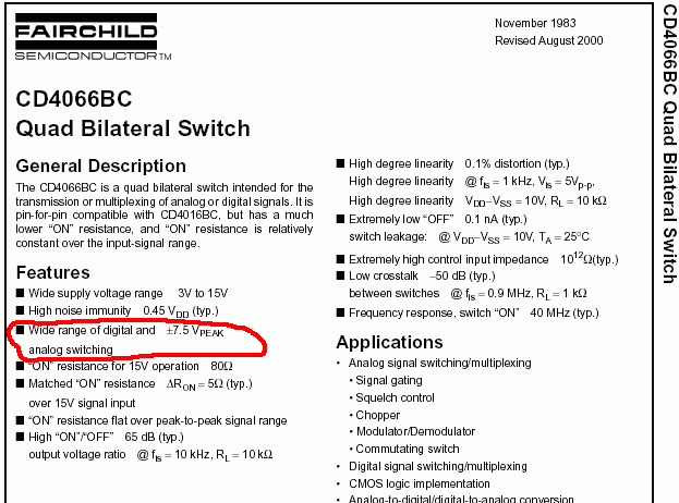

cmoss 4066:
I'm switching an 8 volt circuit with this switch.
Looking at the data sheet, circled in red, is this switch only allowed to switch a max of 7.5 volts?

See Analog Devices **broken link removed** and **broken link removed**. The Supply Voltage column will be of particular interest to you. Also check out Maxim, and maybe some of the other analog IC mfr's.

Hi Screech,
What are you switching?
The 4066 is designed to switch analog or digital low-current signals, not power.
Like all Cmos ICs, its input voltage must not exceed its power supply voltages. You have circled on its datasheet where it says it can switch signals from -7.5V to +7.5V, so that example must be using dual -7.5V and +7.5V power supplies. Instead, you could use a single 15V power supply and it will switch signals from ground to +15V.
To switch 8V, its supply voltage must be at least 8V up to its maximum recommended supply of 15V.
Its control inputs are usually its negative supply for OFF, but it could be as high as 30% of the supply voltage, and its positive supply for ON, but it could be as low as 70% of the supply voltage.
oh, that makes sense.
thanks.
I'm running +8v thru resistors (low current) to a 555 timer thru the 4066 switch.

what Audioguru said is right, I also would supply the chip with at least +0,5 V (and -0,5 V in case of negative power) more than the input signal you want to switch, for example use standard 9 Vdc power supply.
