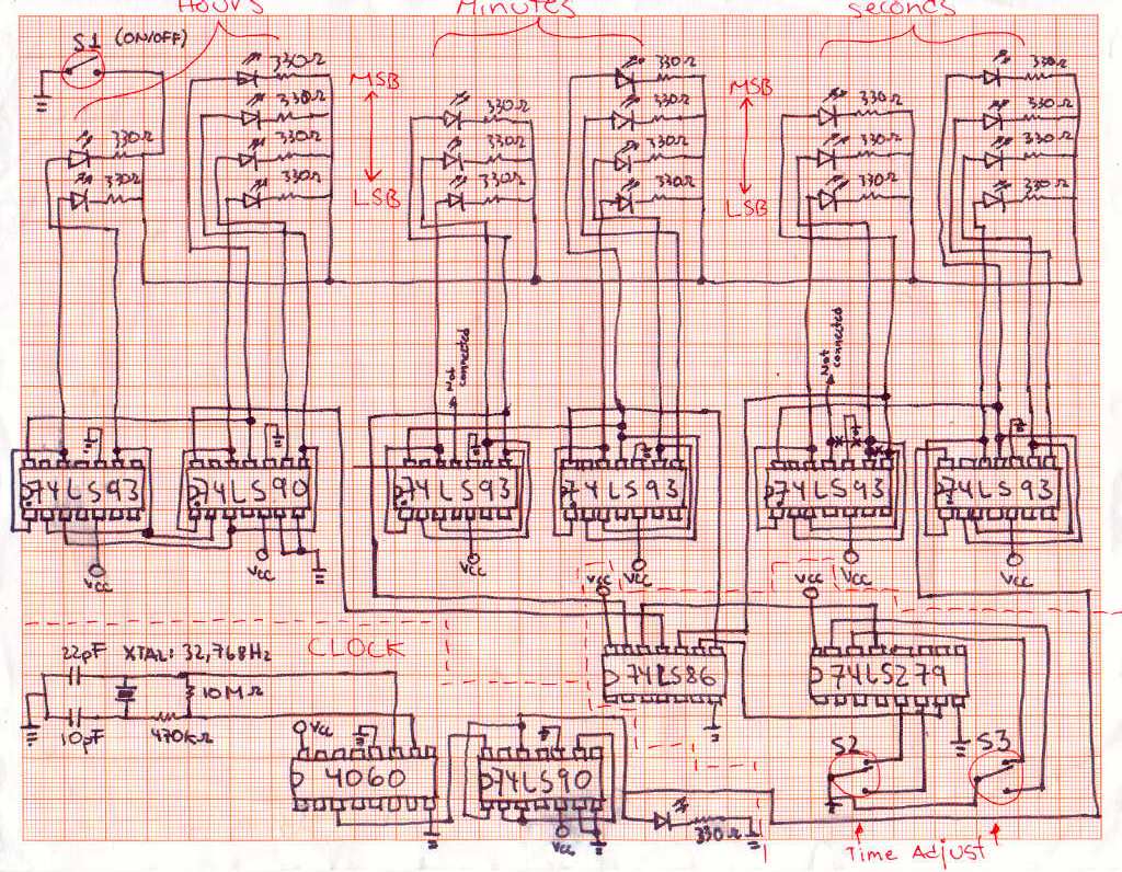

I have built the binary clock from the attached schematic. On my breadboard, it worked great, but after transferring to a pc board, the minutes trigger at 40 seconds instead of 60. The binary counters work as they should...everything seems ok except for that one thing. I have checked my wiring over and over and cannot find any mistakes. Any ideas?

I assume you have decoupling capacitors on the +5V rail.?
Also the 74LS93 is a non synchronous counter so you could have a counter 'glitch'. Try a simple RC filter on the input pin of the hours units 7493.
A 100R in series with the input clock and a 4n7 cap from the hours units pin to 0V.
This should eliminate any mis-operation
Lets know how it goes.
EDIT: Added a sketch

You may have to increase the value of the 4n7, upto 22n0 depends on the width of the glitch.
I suspect the reason it didnt show on the project board is due to the intercapacitance of the plug in contact rows of the project board.

It was the decoupling capacitors. Thank you Eric, for taking time to teach me a valuable lesson on how important they are!
I built that same clock about 6 months ago and mine still works. Add 0.1uf capacitors to every IC and many across the 5V line and make sure that the crystal is as close to the 4060 and GND as possible. Long wires causes false timings.
