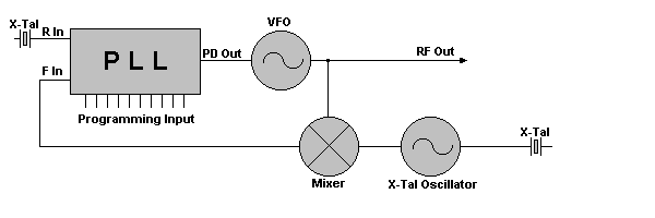

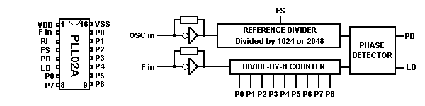

I have a CB radio I am modifying for 10 meter ham use. what I want to do is remove the 40 position channel selector and program the PLL directly off a PIC set up to run as a binary counter , that seems to be the easy part , where it gets complicated is I want to interpret the binary count being delivered to the PLL and display the coresponding frequency on a display , either LCD or LED , the PLL is programed via 8 bit binary and I need the count to run n:101 - n:255 (1100101 -111111 ) and reset , be selectable as a down counter or up and be able to halt the count when the desired frequncy is reached.

PLL frequency wont be an issue , I am just trying to apply binary programming to the divide counters , it is currently handled by 8 binary inputs connected to a mechanical 40 position switch

Question Exo, PORTA is a 4 bit port and being used currently for the up switch and down switch on RA0 and RA1 , PORTB will be dedicated for the programming inputs of the PLL02a, so I am left assuming that if I were to include a display on this pic it would be serial LCD on port RA2 or RA3 ?, I have been looking at the code you sent , I think I am going to enjoy working with pics , very elegant aproach to alot of projects I didnt want to take on , thanks
