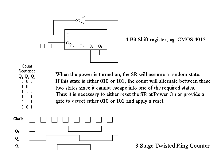

Twisted ring counters also count in Gray code.
For example, a 3 stage TRC counts as follows
000, 100, 110, 111, 011, 001, 000
Len
As Optikon said in his response, there are many possible Gray codes.
The definition of a Gray code is (as Optikon said) that only one bit changes at each step.
A 4 bit Twisted Ring Counter would have the following sequence:-
0000, 1000, 1100, 1110, 1111, 0111, 0011, 0001, 0000, etc.
