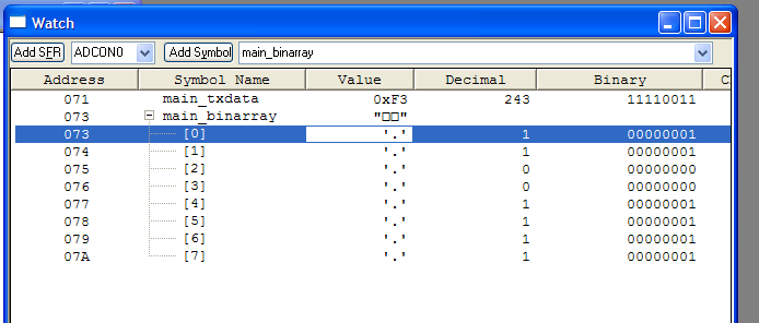

ok but now im kind of weirded out. I don't know if my issue is coming from bad coding or mplab/HI-Tech C.
here's what's going on:
	unsigned char rxdata;
        unsigned char txdata;
        txdata = 0b11110011;     // set an arbitrary binizzel
        rxdata = SSPBUF;        // bring the binary from SDI
        SSPBUF = txdata;        // assign outgoing binary to buffer
        //while (!BF);              // cut for MPLAB Sim
        unsigned char binarray[];
               for( i = 0; i < 8; i++){
                // using txdata for debugging, should be rxdata
                   binarray[i] = ( txdata >> i) & 1;   // this line right here
Ok the strangeness is happening like this...
in the watch window, as I get into the for loop everything looks cool.
i == 0.
I hit the line of code with the >> in it and txdata becomes 0x01.
Subsequent loops: txdata stays 0x01, should stay 0xF3...
the watch window does not display binarray, it just says "" which I dont get either...
Has it really been that long of a day?
That code fails to compile for me. I had to change it to,
unsigned char rxdata,i;
unsigned char binarray[[COLOR="red"]8[/COLOR]];
With the change it works as expected.
Watch window attached.
aaaah the ol' "didn't initialize the array right". One of these days i'll be good at this stuff and see it like a hawk. For the meantime thanks!!!!
