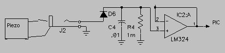

Im trying to make electronic midi drums. Ive got my electronics sorted: A piezo disk into a peak detector op-amp circuit then connected to a pic which sends midi out with its USART. Thats all working fine:
Piezo triggering
Midi activity
My problem lies in that i want to house them in biscuit tins. A big roses tin for a snare, and two other smaller tins for toms. I glued (epoxy) the disks to the undersides of the lids and connected them to a phono socket on the side of the tin. They just dont work right. They work periodically (about 3 in 10 hits). Its so frustrating, i thought this would be the easy part!
The tin where its glued is like those jars or bottles of food where you press the lid and it pops if its already been opened. This doesnt seem good for the disk also as one of the leads fell off after a few presses.
I want it to trigger really easily and reliably so i can drum fast with just my hands
Has anyone used these piezo disks? How did you mount them onto stuff?
The guy who i got the idea from used sheet metal but i thought biscuit tins would be better cos its thinner?
Ive attached my input circuit.

I think the problem might be in the using of hands. The piezo usually needs a hard object to hit it to produce a sharp output rise. Mabye you could have the piezo mounted so that when you hit the tin, it flexes and the metal tin hits the piezo. It probably worked on the desk because your finger was driving it against the hard desk top. Try holding it in the air, tap with your finger then with your finger nail, I expect you find greater reliability with the nail.
Alternatively, it is possible you damaged the piezo by hitting it too hard and now it performs unreliably.
Another possibility would be to use strain gauges on the tins. You could very easily convert the whole system to be pressure sensitive too.
Strain gauges are ultra thin and can be bonded easily to your drum surface.

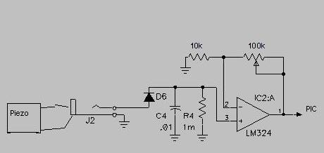

Try adding some gain. The circuit below has a maximum gain of 11.

Thanks Ron, i'll try putting in the gain aswell. I've already housed the electronics into a neat box cos i thought it was working:mad:. Its annoying but im learning i suppose.

Ive tried gluing one on the underside of a proper metal plate, and adding the gain. This has helped a bit, it triggers ok when i tap the ceramic, but its still no good when tapping the other side. Can i just keep increasing the gain until it triggers by hand?
ps. where can i get some rubber:eek:?? I tried glueing a mouse mat to my biscuit tins but it looked crap.
Hand triggering is quite difficult. I'd hurt my fingers trying to get anything out of my set without sticks. You may just be able to increase the gain, but i'm not sure it'll be reliable then (my set sometimes false triggers, I think it is due to static build up)

Long time since I worked with op-amps, but why the diode? Check the input to the amp with an oscilloscope, DC coupled, before during and after you do your drumming. Seems like you will have a voltage shift due to the diode and the R-C time constant. Maybe substitute a cap. for the diode, if anything is needed at all.
