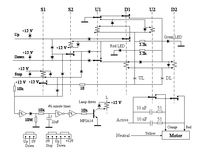

Here is a relay garage door controller that I designed when the electronics in mine failed and the company would not give me a circuit for it. The IC is a 40106 Hex Schmitt trigger. The 3 unused inverter inputs are connected to gnd.
The Up Down & Stop inputs are connected to the output of the radio receiver and to push buttons.
I intend to replace it with a PIC version one day since there is no protection against overload if the door was obstructed by something. (once our deaf cat's head was caught as the door came down, fortunately this was before the electronics failed so the electronic overload sensor turned the motor off).
It does not use bistable relays.
I bought a radio receiver and remote control transmitters from Oakley Electronics who are located in Sydney.

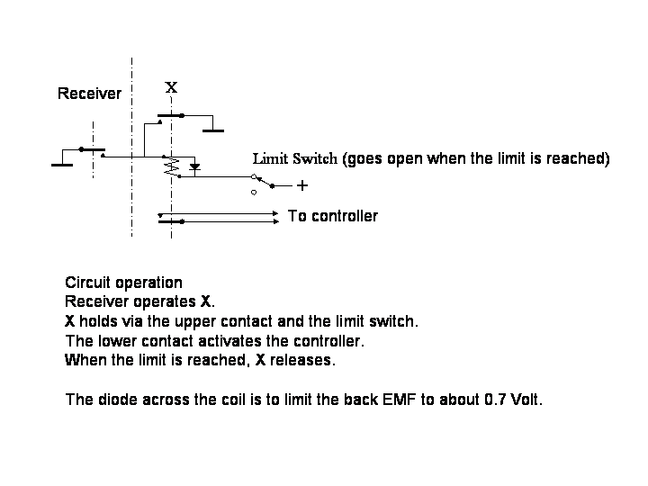

Okey, well I'm not wed to bistable relays, just a thought. All I'm trying to do is to use the output relay in the remote control receiver to control the actuator via the wiring for the handheld control, which has momemtary up and down switches. For the purposes of this discussion, lets just talk about a single function, as I'm using a seperate receiver for up and down.
As I've mentioned the problem is the receiver relay does NOT stay pulled in by design, its just activated for an instant. Since this is a standard garage door remote and receiver I'm just trying to do the same thing the controller does in a a commercial garage door opener. The bistable relay only needs a short pulse to reset so one approach would be a one shot capacitor circuit fired by the limit switch, that would additionally potentialy give the ability to have reverse polarity(compared to the receiver relay output) allowing me to use a single coil bistable instead of a harder to find and more expensive dual coil

Here is the basic idea of how I would do it.
Note that both contacts on X are N/O (normally open).
Edit. Attachment replaced. The diode was in the wrong direction.
Well Sir, I have to say, who needs a stinkin' bistable relay? I presume your diagram is the 'hold' relay idea which did not sound feasible to me but silly me did not think of a DP relay. This is exactly what I was hoping for...simple, fool proof and no special parts. Thank you very much and Happy New Years.

The use of holding contacts has been used for many years in relay systems.
I suggest you think about the prevention of possible misoperation, for example, if the up button is pressed while the door is going down (or vice versa) you don't want the motor to reverse. In my garage door circuit (that I posted previously), you will see that the motor is stopped if either the up button is pressed while the door is going down or vice versa.
