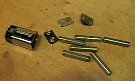

A PP3 9V alkaline or Ni-MH battery uses AAAA cells which are tiny and have a very low capacity that is about 1/13th the capacity of AA cells.
