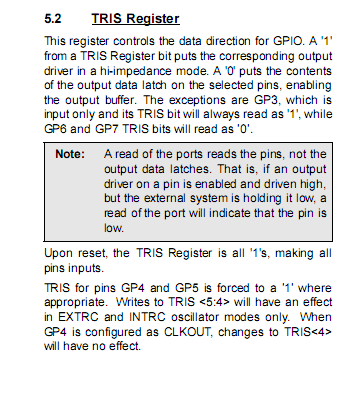

I have been trying to do some bit manipulations on a P12F675 and it doesn't appear to be working as I expected. BSF seems to set the right bit but clears all the rest. For example:
The following only leaves bit 5 on,
code assembler
$1405 BSF GPIO, 0
$1485 BSF GPIO, 1
$1505 BSF GPIO, 2
$1605 BSF GPIO, 4
$1685 BSF GPIO, 5

Look at page 25 of the 12C67x datasheet, ref GPIO reading.:)
Read-Modify-Write issue, isn't it?
After the first BSF instruction, the port might not have time to respond to this command. The second BSF read the port and sees '0' on GPIO0, then it sets GPIO1.... This repaeats until the last BSF set one bit to '1' and the other ones are '0'.
Try inserting a couple of NOPs between each BSF instruction.
A better tecnique is to move the the port bits the W register and set the pin values with IORWF or ANDWF instructions.
Thanks for all the input , it seems to that using a seperate register to do the bit seting overcomes the problem.
thanks again
Andy
I suspect you haven't turned off the analogue inputs. Any pins setup as analogue (the default setting) read back as zero and so a bsf will write zero back to the other pins. Try writing zero into ANSEL (bank 1) and your problems will disappear.
