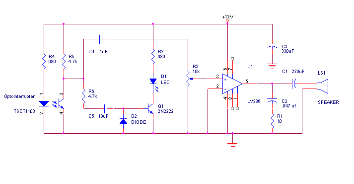

Hi Duffy
I bought a sensor rather than wait for a mouse https://datasheet.digchip.com/513/513-05316-0-TCST-1103.pdf I hope this is suitable. If it is would you mind having a look at how best to integrate it into the circuit I posted above, assuming that is if the circuit is suitable.
I would assume that the sensor sends a signal when the path between the two sides is unobstructed?
Cheers
Andrew
That sensor will work just fine. Yes, the sensor sends a signal when the path is unobstructed, it turns the detector "on". Yes, the 10k pot is the volume control.
Here's your revised schematic. You had the LED backwards and the resistor was too low for 12V. I removed the 10µF cap from the LM386 because it won't need the gain of 200, added a power supply cap, changed a couple of the values to ones that are easier to find (a 220µf cap is a lot more common than a 250).
R6, C5 and D2 stop the LED from being on all the time so it will just blink once per interruption.

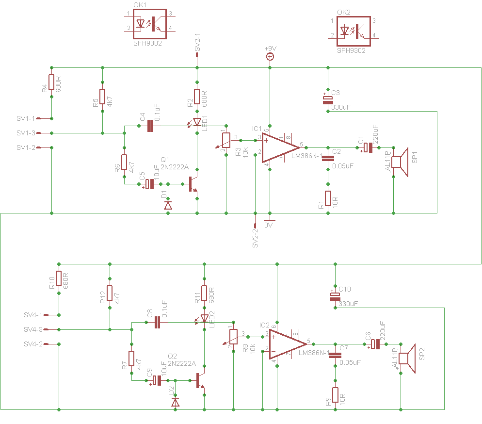

Hi Duffy,
when you get a moment won't you check the following schematic. I have duplicated the circuit for two channels. I have also commoned the power supply and made allowance for the opto's to be off the main board.
Could the common supply cause other issues?
I think I only need a 3 pin connector for the opto as two of the pins are commoned?
Cheers
Andrew

Bite Indicator ....... nearly there
Hi Duffy,
have breadboarded the project but I think either I have connected something wrong or some values need tweaking.
Diagnostics/B]
Apply power - Buzzer beeps once, LED light up and stays illuminated
Set Gain Pot to Min (interupt sensor slowly) - No sound DUH, LED dims slightly for a fraction of a second but not when beam is broken but when beam is restored .
Set Gain Pot to Max (interupt sensor slowly) - No sound DUH, LED dims slightly for a fraction of a second but not when beam is broken but when beam is restored.
Set Gain Pot to Min (interupt sensor rapidly) - No sound DUH, LED dims slightly for a fraction of a second but not when beam is broken but when beam is restored.
Set Gain Pot to Max (interupt sensor rapidly) - Nice clicking sound but much softer than anticipated, LED dims slightly for a fraction of a second but not when beam is broken but when beam is restored.
When in rest state the LED stays illuminated.
So could have connected something the wrong way but is probably unlikely as the circuit works.
Any ideas ..... ?
Cheers
Andrew
You have something connected wrong. That LED will not stay lit in that circuit. Sounds like the cap is bad, backwards, or shorted. Also check the pinout on the transistor, make sure you don't have the base swapped with the collector or something.
