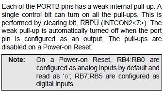

Info in datasheet:
pullup-jpg.30924
Using the above note from datasheet you can see to enable pullups:
	movlw    0x80
	movwf    INTCON2     ; Set pullups
OR
	bsf    INTCON2,RBPU     ; Set pullups
And since RB4:RB0 are auto set to ANALOG on startup it will always read as a 0 until you set it as digital:

Now to figure how to set ADCON1 you have to find this:
I edited the image so you can see how the registers line up so you can see which PortB pins have what name in ADCON1 register. So you can then:
	movlw    0x7F
	movwf    ADCON1      ; Set to all digital
or just set the ones you need RB0, RB2, RB5:
	movlw    b'00100101'
	movwf    ADCON1      ; Set RB0, RB2, RB5 digital for button input.
