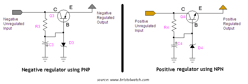

I thought that NPN (Negative+Positive+Negative) passes Negative supply (like N-Channel FET) and PNP (Positive+Negative+Positive) passes Positive supply (like P-channel FET) when Base of it is powered. But seeing these two voltage regulator which are opposite than my understanding.
In the circuit NPN is passing positive supply and PNP is passing negative supply.
My questions are-
- how NPN passes positive and PNP passes negative supply?
- how transistors pass regulated voltage through CE if base of it is regulated? (I know emitter have 0.6V less than base voltage though).
Please tell me the operations (maybe path of current/voltage flow and working principle) of these regulators in simple words (circuit analysis). Simple words because I am just a hobbyist. Thank you!

The transistors are configured as emitter followers, effectively creating a low impedance zener sometimes called an amplified zener. The zener holds the base voltage steady and the emitter follower then delivers the same voltage shifted by 0.6Vbe at its emitter.
In a BJT, when a small current flow from the base to the emitter, that allows a large current to flow from the collector to the emitter.
In the common-emitter circuits you are probably more familiar with, the base current flows to ground, and the collector current the useful output of the circuit.
In the emitter follower circuit shown, the emitter current is the useful output of the circuit. The zener hold the emitter at a constant voltage. The base-emitter drop of about 0.6 V means the emitter will be around 0.6 V lower than the zener voltage. When current is taken by the load, some comes from the base, but this base current is amplified by the transistor, so nearly all of the load current comes from the collector.
This has the advantage over a zener regulator that the resistor and zener can take far less current than the output current, so with no load the regulator takes little current.
https://en.wikipedia.org/wiki/Common_collector may help but it is a bit mathematical.
Don't think about polarity, think about current direction.
Just remember that the normal current direction in a BJT goes in the direction of the emitter arrow.
Thus it flows from base to emitter (also collector to emitter) in an NPN, and flows from emitter to base (also emitter to collector) in a PNP.
Similarly the current direction is from source to drain in an N-MOSFET, and from drain to source in a P-MOSFET.
(The arrow direction on a MOSFET can be a little confusing since it shows the substrate diode direction, which is normally reverse biased. Thus the drain-source current direction in opposite to the arrow direction).
If you follow those rules then you will always be able to determine the relative voltage polarities across the transistor connections when operating normally.

Your thinking about what constitutes a NPN or PNP transistor is misguided. N and P refer to the doping added to the pure silicon during manufacturing, not the voltage applied to the leads when used in an application. Don't try to infer how a circuit operates by comparing a BJT to a FET. A BJT is a bipolar (two charge carriers) device that works by diffusion, whereas a FET is a unipolar device that works by constricting the current. Both are voltage controlled devices.
What does passing a certain polarity voltage mean and what difference does it make?
My questions are-
The first question does not make sense.
For the second question, the transistor controls its CE current according to the voltage applied to its base.
OK, as stated before, a transistor operates by changing its CE or EC current according to the voltage applied to its base, provided the transistor is properly biased. The current existing in the base is waste current that is lost from the CE path. It is proportional to the CE current (beta), but it does not control the CE current. As others have told you, the circuit is an emitter follower, i.e., the emitter voltage follows the base voltage, and differs by an offset voltage of around 0.6 volts. The zener diode keeps the base voltage constant, and thereby the load attached to the emitter will also be at a constant voltage. The transistor will automatically adjust its CE current to assure the emitter load is at a constant voltage. That's about all you have to know. Ask if you have any specific questions.

A transistor by itself responds to its Vbe, not the base current. The physics of the BJT transistor proves that. It is true that the wasted base current has an exponential relationship to the collector useful as an indicator, but this base current does not control the collector current.

NPN and N-Ch Enhanced are used as low side switches. PNP and P-ch enhanced are used as high side switches. Switches are always inverting from Base to collector or Gate to Drain
Emitter Followers are non inverting Current buffers.
