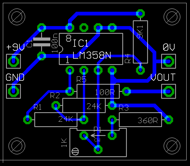

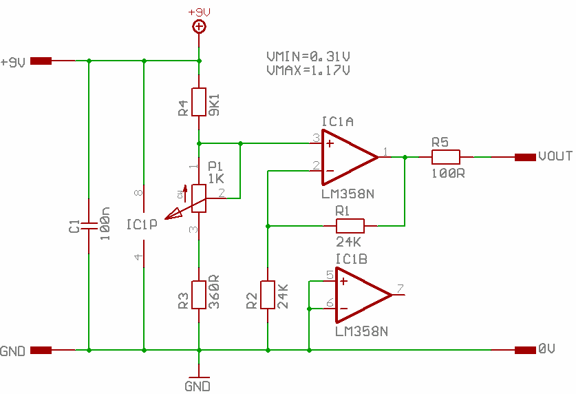

here are schematic and PCB layout. The output voltage can be varied between 0.31 and 1.17V (standard value resistors)
You might use a potentiometer instead of a trimmable resistor.
Use a 9V block battery for supply.

Here's one P/L
9 V battery
8.2 k resistor
1 k pot
The pot wiper is the output.

The Schematic using the LM358 has a "typo" for the gain network, is Av of 2 needs to be Av of 1.

One way to fix the "typo" in the LM358 circuit would be to not install R2. You can install a jumper in place of R1. This will set the gain to 1 and the voltages available will be 0.34 to 1.17 when the battery is at 9.0 volts.
Another way would be to leave the gain as is and modify the voltage divider by changing R3 to 180 ohms.
