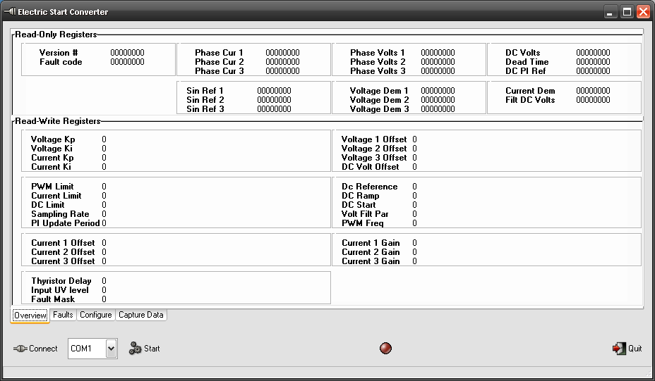

Also wrote a GUI app to interface to a controllerboard we have built with an FPGA and a FTDI chip. Using the FTDI dll I can access the chip and with the pre-defined messages sent can control the board with python via USB (got a funky plotting function atm, plots using matplotlib in the GTK gui).

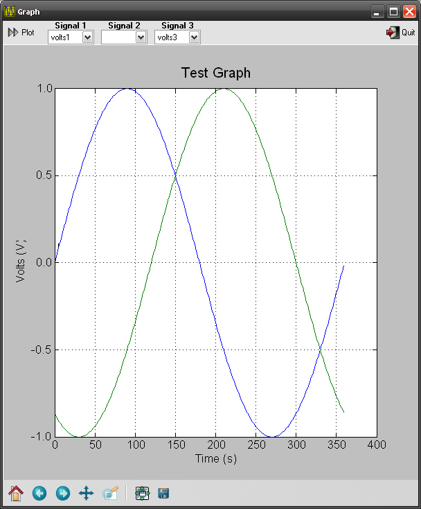

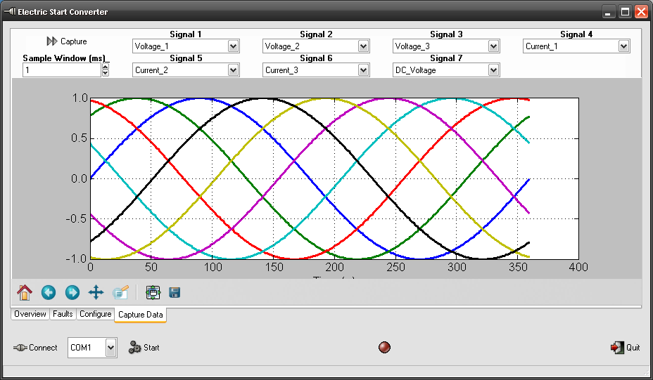

Here is a couple of screen-shots for a program I wrote to access that controller-board. This is an older-version (this one was using RS232, moved onto USB now :D, and a few other things changed). the other shot shows my virtual oscilloscope I wrote (the client side and helped on the VHDL side). It shows a 7phase test screen which gets replaced upon capture
Also here is the code for a quick plotting GUI (3rd piccy).
This one was actually testing:
plotting and plot-replacement in Python+GTK+matplotlib
have fun

This code had the GUI built from GLADE to layout the GUI and then a few lines in python to call that GLADE file and attach callbacks to functions really simple. The GUI could of been built line by line (container here, button there) but whats the point?
