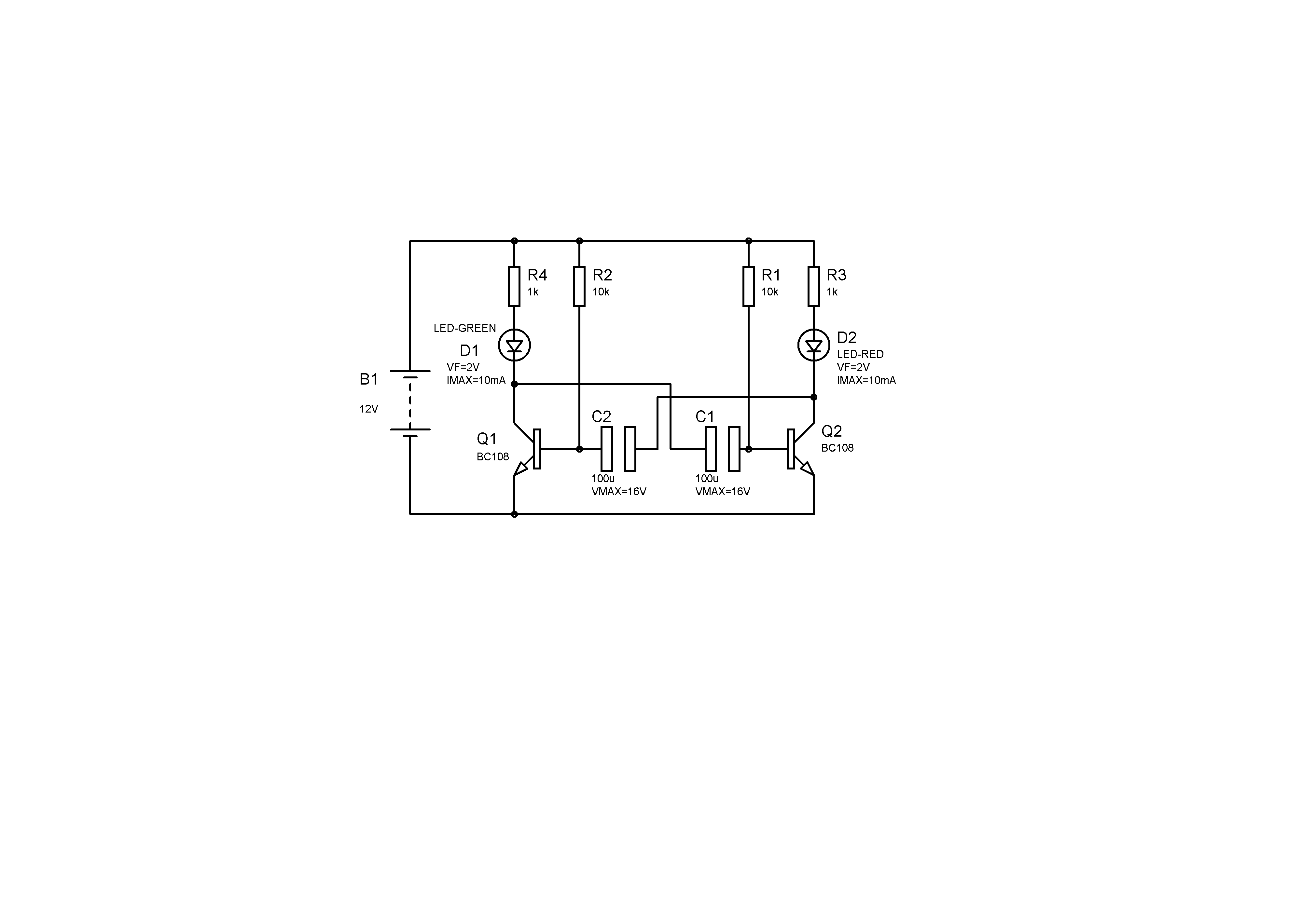

Today after getting several advices from audioguru I went to make a flasher based upon "cut off" and "saturation" regions of BJT transistors (I think it does work based upon those regions though!)
1: I would like to know if my design (resistor values) is just correct??
2: I want to know how to calculate the values for both capacitors (I think I have a RC circuit, if so how to calculate the values for say 2 seconds of blinking??)
3: My simulator does not show any blinking for the LED's with these used values and both are lightened simultaneously!? What's the problem really??!
Hope you guys specially professors "audioguru" and "MrAl" help me out to learn to design these switching circuit (though I am a newbie but I know the formulas for RC time constant circuits and Cut off/Saturation situations of a BJT)

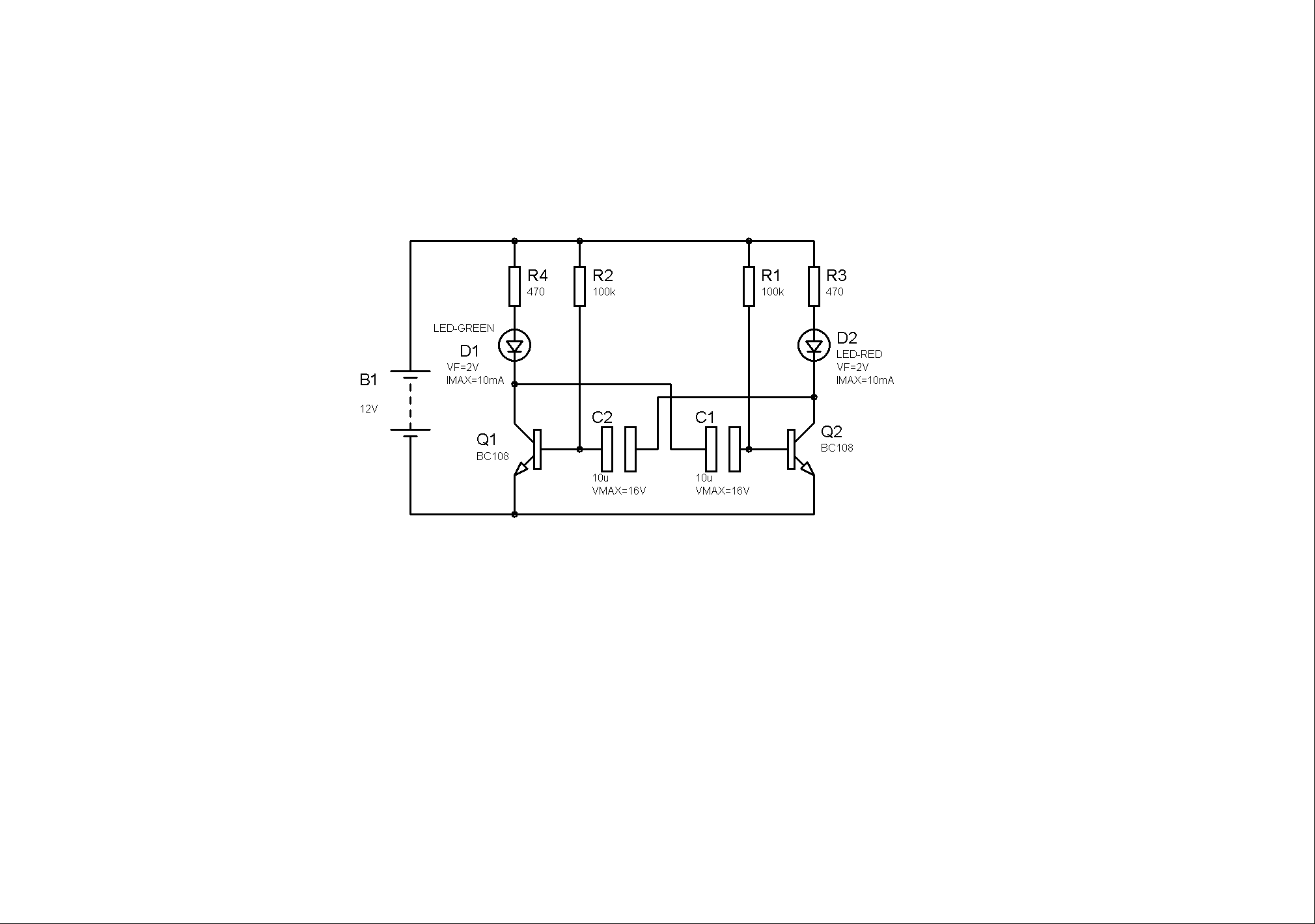

I changed the values and now it blinks! So it seems to me that it does not follow the cut off/saturation conditions? What is your idea???

In a simulation program both transistors are identical so they turn on at the same time then stay turned on.
But in the real world one transistor will have more gain than the other and it will turn on first which starts the two transistors to oscillate.
Frequently the circuit being simulated must be "kicked" to get it working.
The simple circuit does not "blink" the LEDs. Intead is alternates which LED is turned on. The average current is the same as one LED that is continuously lighted.
EDIT:
The supply voltage is too high. The max allowed emitter-base voltage of the BC108 transistors is only 5V. The bases are tried to be driven down to -10V which causes avalanche-breakdown of the emitter-base junctions which is bad for the transistors and changes the calculated timing.
The supply for the circuit that drives 2V LEDs is 7V max.
Diodes can be added to stop the avalanche-breakdown.
Ok, we have change the BC 108 by every another NPN transistor which does work, Now I would like to be able to analyze and specially be able to calculate the time constant for a such circuit.

Reduce the supply voltage of the circuit to 6V then look for Transistor Multivibrator in Google. Be careful because a few links are wrong with the polarity of the capacitors backwards. The calculations are shown.

Hi there,
What is it exactly you want to know about this circuit?
You probably already know that when the cap charges it charges close to
the full supply voltage, and when the transistor who's collector connects to
that cap goes low (turns on) you end up with a very negative voltage at
the base of the other transistor, and many transistors like this are only
rated for about 5v for reverse Vbe.
That aside, you need to calculate the time constants that result from the
way the circuit is connected. You can start by assuming one transistor is
already turned on and the other turned off, and the voltage levels that
result from that initial setup.
Another idea is to put resistors in series with the caps, which would require
two more resistors. This gets you a longer time constant for the price of
two resistors instead of larger caps. That also can solve the reverse bias
Vbe over voltage that results from the cap charging up as mentioned above.
Some circuits are easier to analyze than others. This one has some non linear
features which may be a bit harder to deal with for exacting calculations.

R (ohms) times C (farads) is one "time constant". The resistor charges the capacitor to 63% of max in one time constant and the capacitor is 99% fully charged in 5 time constants.
The simple two-transistors multivibrator circuit you posted saturates then cuts off each transistor if the supply voltage is reduced.
