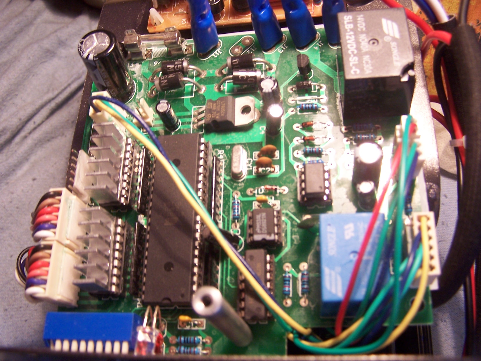

Umm, have a look at the pic i attached, its more than just a light bulb! It is what they call a "intelligent scanner" in the lighting world, and you can see why in that pic, not a matter of replacing a light bulb! Oh and thanks for the jaycar part no., will have to go down and get one!
I was thinking something similar. Dimming is not like relay switching--and stage lighting is not like simple home dining-room dimming. We used to use stage lighting rigs which required a refrigerator-sized dimmer bank on both stage right and stage left (one for the front towers, one for the back). These things were by weight mostly transformers and were *heavy*. The only thing we had which rivaled them in weight was the box we stored the lighting power cables in (when it was full, of course).
Torben
what do you mean what is it from? Its a light, or scanner, or whatever you call it, basically it projects patterns, that can be panned/tilted, colour changed ETC, and its more than just a dimmer on that board, its a full 3 stepper controller, DMX capable, sound mode, and all that other stuff. More info on this light is here **broken link removed** But wow, refridgerator sized dimmers! How many pars were you running off that beast???
yes an iColor is one of those except different brand... eg. Robe, Trackspot, Giotto etc. etc.... I'm a sound donkey so my lighting knowledge is minimal, lol...
