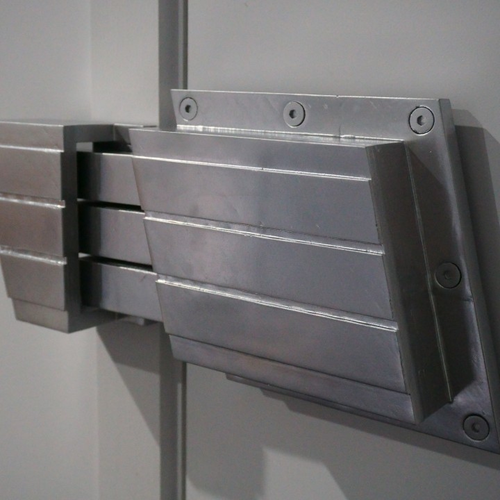

Yeah, go with cowboybop's way. Making something that "works with everything" (i.e. works with any lock whatever it may be) adds several layers of unneeded difficulty. Like a Jurassic Park door lock:
